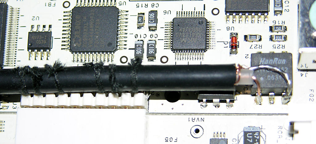

« Reply #3 on: April 14, 2010, 10:31:46 am »
Well I got off my backside this afternoon and hardwired a 75ohm coax lead onto the card, thus negating the need for that breakout dongle that kept falling out whenever I moved the PC. Doing it this way also negates the need for an additional socket/plug combination.
Tricky part was how to secure the coax cable so that it wouldn't break off from the solder pads when inserting card or removing. I had thoughts of making up a tiny bracket upon which to cable tie the coax, but ended up with an elegant solution of simply binding it to the legs of the middle header connection, using thin cotton yarn. Nice and secure. The coax cable looks huge when laid beside the little surface mount components .. haha
