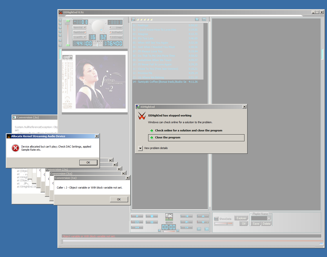

Another error occured while playing hdcd (I guess someone mentioned that before...) Here is a nice screenshot.

« Reply #89 on: May 28, 2010, 07:56:20 pm »
Because large redbook files were taking too long to process, I tried changing core appointment schemes from 2 to 3 to see if that would speed things up. It didn't. Instead I got the "Engine3.exe stopped working" which is really weird cause I was in Adaptive Mode. When I switched to Scheme 3, I did change the buffer to 4096, which was correct last time I checked several months ago. (Danny, how do you get a buffer of 256 with the Hiface?)
When I changed back to the Scheme 2 core appointment i got the "device allocated but can't play message" and had to reboot to get things going again. Frustrating.
9z has definately slowed down, in all ways, from when I first started using it. Opening a new album and hitting play takes several minutes for music to begin. I've also begun to experience dropouts with redbook files. That's never happened before; occasionally it would occurr with a high rez file but never 16/44.
Sound, however, remains great.
