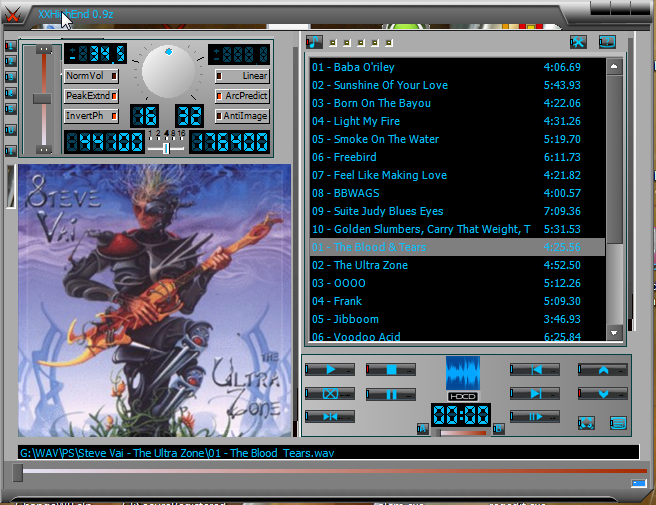

I just tried Steve Vai - The Ultra Zone (didn't look for the other), and QAP no problem. But ...
I think we may have another problem ...
For 4x Linear and AP, the HDCD indicator is lit up and I only get the left channel.
The bold is mine;
Somehow (and don't ask me how exacty at this moment), the HDCD decoding is processed twice. For now the solution should be to turn it off in your processor ... if you can. AKA "in XX you can't either".  Happy
Does that help ?

Just saw your image - you have the HDCD version. OK, let me try something...
« Reply #12 on: May 25, 2010, 11:22:00 pm »
Just wanted to say that, yes. That's why I showed the picture (without sound, sorry Happy).
That things happen differently with AI I can imagine ... a matter of using the wrong sequence of things in the program (like first applying the upsampling, and then try whether it's HDCD encoded -> never tried it).
So, with AI it probably just doesn't work (the decoding).
