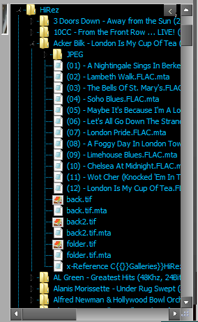

Can you confirm this *only* happens when the treeview (left pane) has the XP look (for the nodes, see the +++).

When you always have the XP look (see below for the Vista/W7 look) I guess you don't have Themes on or so ?

your picture of the tree is exacly what I see.
I did shut down many services, so that may be the cause of the problem !!

Sorry, not quite,
the difference is the small boxes with the + sign in it.
That is the XP view.

But those Plusses (XP look) ...
I tried that too, but the point is that this (now) operates in an expected environment, while in your case I doubt that. These plusses shouldn't be there ...
What you could do for checking whether this "plusses thing" actually causes it :
Start a track in Unattended mode. Now startup XXHighEnd again (this will be the situation you *will* have plusses (eh, when you told to shut off the Services in the Settings Area)), and if *now* you can't let it go wrong it will tell me much.
