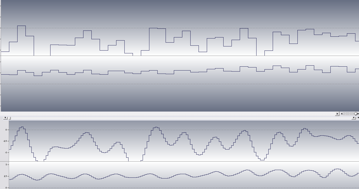

Ok, I wanted to do this more extensively, but it really takes too much time. Anyway, below (also see next posts) you see a few pictures.
The first one here shows Josef's 44.1 take at the top, and Mani's at the bottom;
To me it is clear that Josef's version is better. It shows more detail, and it better follows the original;
Hard to explain by means of just this one picture, but what I see, I see back everywhere. Look at the bottom channel of the bottom picture (Mani's version) for an example. You there see two situations (one at 1/3 of the screen, and one at 1/2) where two adjacent samples have no difference in amplitude. With this in mind, already in this one picture you can see that the amplitude (volume) steps generally are smaller in Mani's version.
Notice : It is not said at all that larger steps are better, but it is about following the original better (see next posts).

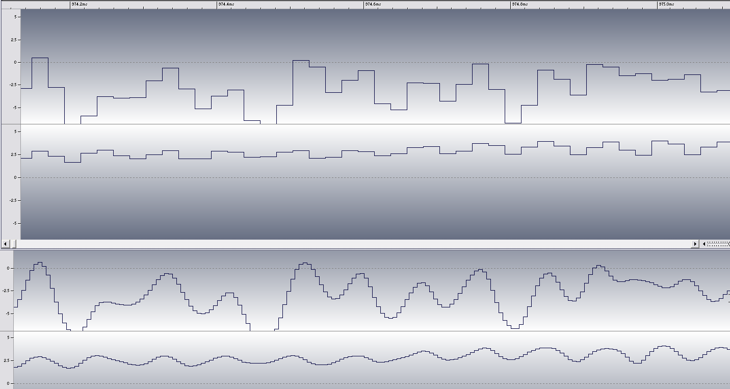

« Reply #36 on: August 19, 2010, 03:40:12 pm »
What we see here is Mani's version compared with the 176.4 "original". The original has 4 steps sideways where the 44.1 has 1.
Look at the top channel just before the middle; The original shows the tendency of the downgoing slope being higher in amplitude than the upgoing slope preceeding it; You can see that the samples at the other side (the right side) of the slope are higher in amplitude than at the left side. However, Mani's version shows it the other way around, and a downwards going tendency.
If you look more to the right, you see similar happening at the top channel (Mani's version) where the wave disappears under the horizontal line. It shows an upwards tendency, while the original clearly shows a donwards tendency (compare with the left side of that wave).
Try to see more of this yourself ...

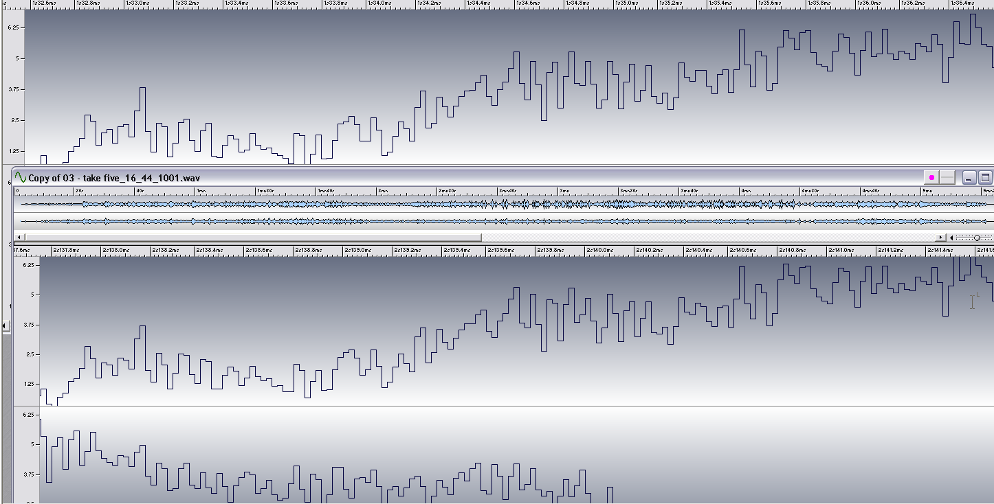

« Reply #37 on: August 19, 2010, 03:48:20 pm »
Here we see Josef's version against the "original". Read the text from the previous post again, and see that here things are as expected.
Well, as how I see it. Happy
Also look at the second peak from the left, and what happens in front of it. Look at the down - plus upgoing small slope and compare it with the original. Yes, you can sense Mani's version (previous post) as better matching, but in the mean time that shows nothing of a smooth going up again, where this one does. But, doubtful in this case.
But, just look, and "feel" that this is al a better representation;
I have done it for several of these pictures, and they all give me this same feeling.
