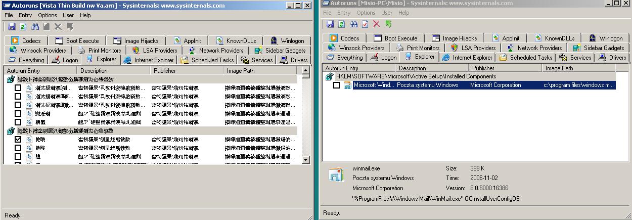

Nick, your settings are in Chinese or other language that I can't read. Is there any way I could change it? I'm a bit afraid to apply it on my machine, because it seems that there are different entries here..

Marcin,
Chinese  unhappy I did not expect that. I think that it is possible that your autoruns install has in the wrong language. How do the settings of you pc display when you just load autoruns? are that ok.
I will take a look at the file too to see if any thing has gone wrong looks like a character set problem.
Just so I know where to start with notes have you installed the autoruns program from the link I posted. You proberbly already use the program maybe ?

My reason for posting my .arn file us that this gives precise details of what a thin build can run without and sound ok. What I think folks might do is to manually transfer the settings that they want to try between two copies of autoruns running on their machine. One copy open with their machine autoruns displayed to be edited and the other copy looking at my .arn file. This should only be done with some thought to what is happening and on a boot that is experimental and therefore it doesn’t matter too much if things don't go well. I have done this process in the last couple of days to rebuild my thin Vista after the AHCI problem and its not too difficult to do and since I was not bothered about losing the Vista boot it took 30 mins to transfer all the settings over.
Autoruns frustration.....
I have spent the morning trying to get to the bottom of why Marcin is getting Chinese characters when he opens my .arn file. It appears the current autoruns version 10.3 is not compatible with my file which was created in v9.35 ! I tried installing 10.3 on my machine to read the .arn I posted but I got Chinese characters as well. Then I tried to generate a new .arn file with version 10.3 and hit a known bug with Autoruns which is that this version will sometimes not display all of the intended categories correctly (only about 15% are listed). I therefore cannot create an .arn file with a complete list of what is no my PC using the current version 10.3. @**$£!!!!!
Possible solution.....
The only option I can think of is to post my .ARN file and the version of autoruns needed to view it v9.35 with so folks have the same software. Do the forum rules allow me to post an executable? I think the licence is a freely distributable one.
Out of interest can you Autoruns version read the .arn I posted ?
