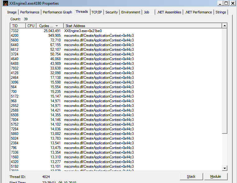

Hmmm - I think I've found a method which clearly demonstrates that XX indeed behaves _very_ differently when run from RAM disk!
Experiment is simple: make a playlist with 1 track (preferably short so you don't have to wait long for results but it works with any length). I used Pink Floyd's 'Goodbye Cruel World' (The Wall) as it lasts only 45 seconds.
It does not really matter that much what settings you have but, to simplify, disable 'Copy to XX drive' and make sure Split File Size is big enough for your test track to fit in RAM in 1 piece (I just set it to 100MB). And, oh yeah, I used a WAV file as input: no FLAC conversions etc and no upsampling mumbo-jumbo: just straight 44/16.
Open Process Explorer, open XX from RAM disk and play the track in Unattended mode.
You should see something like this on XXEngine3.exe properties dialog: (Capture1.PNG)
XX has 9 threads of which only 2 are active 99% of time. This makes sense: one thread for XX and other for .Net main loop: Nice & clean.
Now try running XX from OS disk (does not matter if it's HD or SSD) and look at same dialog: (Capture2.PNG).
Ouch. Instead of 9 there are now 39(!) threads and about 32(!) of those are active 99% of time!
And all these damn extra threads keep 'context switching' all the time so at end of song there are in total about 10,600 context switches (~240/sec): (CaptureOS.PNG)
In contrast, when XX is run from RAM disk there were in total about 5,600 context switches (~120/sec): (CaptureRAM.PNG)
Don't ask me what 10x more threads are doing and what 2x more context switches do or mean but my gut tells me that more threading & switching probably is not good for music playback....
And a small shocker for the end: Try the same thing but start XX from _any_ disk (HD or SSD) as long as that is not OS disk and you should get pretty much same numbers as with RAM disk Happy
So, it would at least seem that XX is best run from a non-OS disk.
An exciting speculation is that perhaps less context-switching has beneficial impact on sound quality?
Can somebody run this test on Vista and let us know if Vista does indeed make less context switches? (I used W7)
If it does, then perhaps we can push Peter to investigate how to make XX do 0 context switches in next version? Happy

« Reply #18 on: October 07, 2010, 01:30:49 am »
>That would explain why Mani experienced better SQ running XXHE from a 2nd SSD, compared to running on only one SSD, wouldn't it?
Yep, sure seems that way Happy
Still, I speculate that RAM disk is probably always a better option as everything is contained within MB i.e. less internal/external hardware gets powered up/down around and more stable power is always preferable for audio....
Fun part is that implications of using #context-switches as measure may go far beyond: For example, what if it can be used to explain (at least to a degree) why different players sound different even though they are all bit-perfect?
And why, e.g. Foobar set to pre-buffer music into RAM before playing and also using KS or WASAPI still sounds worse (eh, different Happy than XX?
So, for fun I tried same experiment with Foobar. One thing immediately becomes painfully obvious: Foobar is context-switching like crazy all the time - even when not playing at all Happy Interestingly, this does not seem to change during playback very much and is very similar to what XX does when run from OS disk. However, #threads is drastically better (=smaller) with Foobar and does not seem to be affected with where Foobar was started from...
So, there seems to be some code in XX which, for whatever reason, is highly susceptible to where XX is run from.....

I's a bit late to explain it all in detail now, but indeed open Process Explorer edit : Resource Monitor, and look at the CPU graph THE BLUE LINE at various SFS settings, and file sizes; This blue line is about the processor speed ...
Whatever it is you see, it is not related to anything I do, *except* for the CPU getting more active because a track part has to be loaded. So, at SFS=12 you understand this easlily. But now look at SFS=70 vs. SFS=200 etc. ... '
Does it make any sense to you ?
The reason I didn't post it yet, is because I found that this is very different in W7 vs. Vista. Also, it is different per MOBO "implementation". So, in the end I couldn't see the common denominator, hence the sense of it all. However, it looks like the processor speed is doing it to us all.
Think of something like "when the amount of memory to have under control is larger, it takes me (the CPU) more time to keep that control". But also : "when it is time to load a track part, well, I have to do something for that".
With this in mind, you will start to see how SQ can be so different, and the graph (blue line) just shows it.
But also have the Task Manager's cpu graph in the same screen. Why ? so you can see that the processor speed is independend from the "load" needed. So, CPU cycles needed stay zero all the time (especially when the track fits into memoy), but the speed of the CPU is ony larger.
This is only a small part ofthe whole story, I'm sure, and please keep in mind that this looks totally different for Vista vs W7, will be dependent on energy saving settings, plus it will be motherboard impeeded.
All 'n all we're all on the right track, but we don't know where the train is coming from, nor do we know where it is heading to. Not yet.
