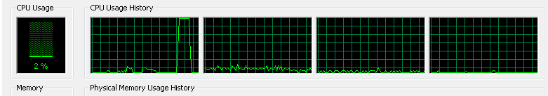

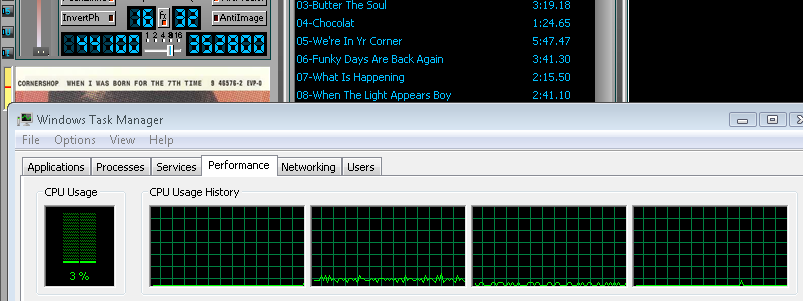

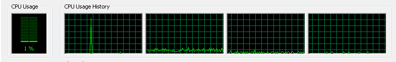

I spent some time observing the 4 core cpu behaviour, and tried to "balance out" things as much as possible. Just a technical approach, but I also think what I ended up with sounds the most normal to me.
So, 2.9GHz per core, Core Appointment Scheme = 3, Player Prio to Low and Thread Prio to Real Time.
Kernel Streaming Special Mode, Driver Buffer Size of sound card = 1024, Device Buffer Size in XX = 1024, Q1 = (1) latency of 32 samples.
Important :
What I now noticed, is that the driver runs in Core #3. IOW, I wouldn't bother much about those interrupt settings, because this is just how it works out with a 4 core processor. Besides that, all the loading stuff is in Core#1 (incurred for by Scheme-3), the Playback Thread in in Core#2 (ditto), and any additional whatever Vista stuff pops up in Core#4. Notice though this does not count for things you start during playback, because at that moment this is not under my control. So that appears "everywhere" (Affinity and "the more stuff" is to all Cores by default).
So ... What you see below in Driver09 is the most balanced and low cpu useage I could find in two hours of time (the combinations are endless of course). Also notice that this is 16/44100 Octo Arc Predition Upsampled (to 32/352800), and the 32 bits internal latency may not be reachable by you even at a lower output sample rate. Don't think "ok, then I make 64 of that 32 samples", because everything changes; not only the Playback Core, but also the Driver Core.
The "Update Speed" in TaskManager is to be set to "High", because otherwise the Driver Core is flattened too much and the various settings won't differentiate (much).
Again, just some technical approach, but as said, I imagine that things sound the most normal at the same time.
Lastly, notice that I used Special Mode because of the additional detail that brings, but also because Adaptive Mode won't bring such a nice cpu graph.
Engine#3 can bring even better pictures, but because of the different working of Q1 *and* the subjectiveness to sound for a certain Q1 setting, I don't think it is useful to approach this in this technical fashion.
Some additional remarks :
Although Scheme-3 appoints Affinity to all processors there's more under the hood, which dictates things to certain processors anyhow. But, for the Driver09 picture I manually put Affinity for TaskManager to Core #1 (careful, because "technically" this is Core#0 but I don't speak like that in here). So, this makes sure it doesn't interfere with the Playback and Driver Core for these pictures and story. But now look at Driver10 below;
What I suddenly learned is that this behaves the same as W7, and the updating of the TaskManager Graph stalls at a track load. This *also* makes comparison with W7 graphs and Vista Graphs tedious, because in the normal situation (TaskManager has affinity to all Cores) it looks like Driver11 below. So, it looks like the loading takes longer, but it is really the Graph which keeps on being updated.
This, while I at first thought it really took longer under Vista, which for me went along with the change of processor (from E6600 to i7/870). Also notice that I applied Nick's "priority tweaks", which *thus* don't end up in W7 behaviour (this needs a bit of upside down thinking), and W7's priorities just *are* dealt with differently.
Hope this is beneficial to someone.
