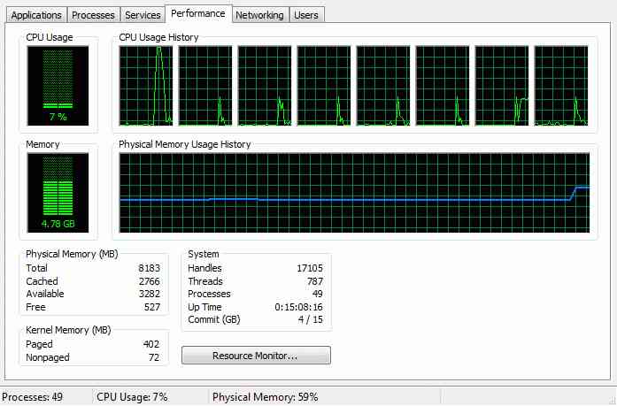

Do you have you virtual memory On ?
If yes, can you - with an SFS setting just working (so a little higher and you have the Out of memory) - show me a picture of the "Performance" TaskManager screen ? (that's the one with the CPU graph on it).
PS: Counts also for Jarek. Happy
goon-heaven
Posts: 31
« Reply #14 on: November 01, 2010, 02:01:02 pm »
Virtual memory 8Gb
SFS= 218 ok. 219 exception
