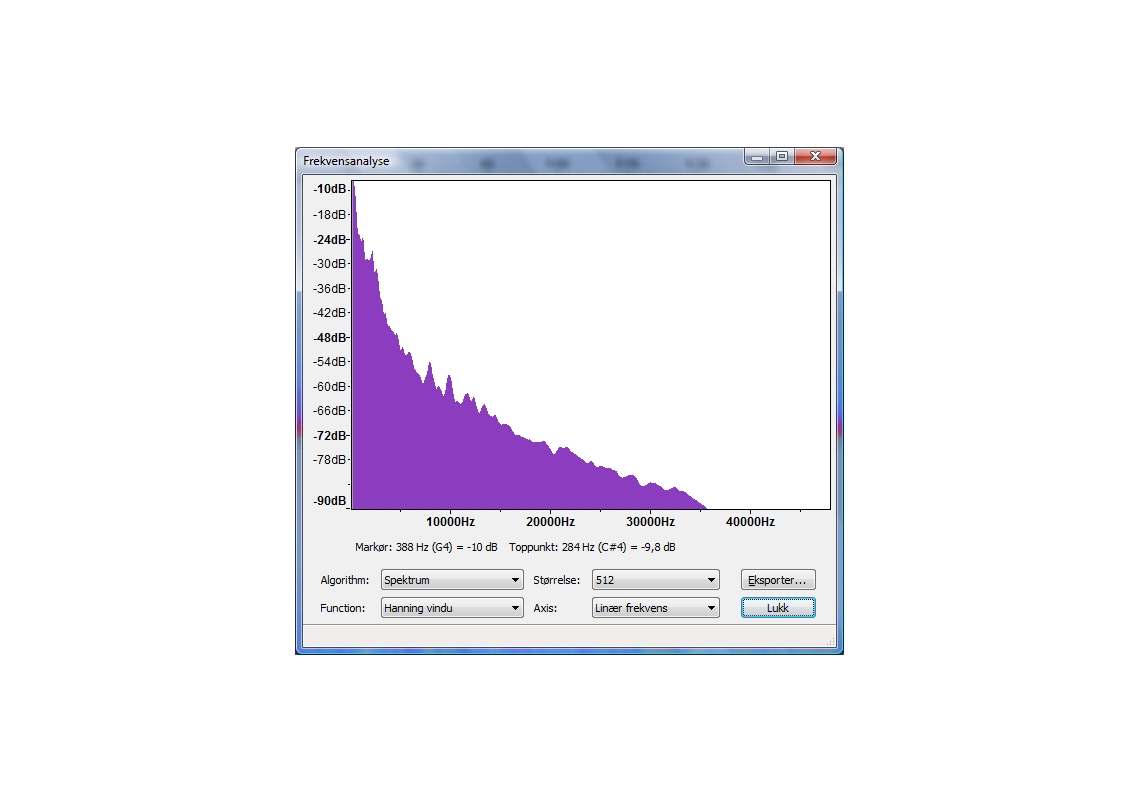

The two following pictures show a spectral content likely to be as it should (24/96):
Rgds.

« Reply #49 on: January 02, 2011, 12:52:26 pm »
That SURE looks more like it !

« Reply #50 on: January 02, 2011, 01:15:03 pm »
Maybe I am wrong all over...
Yes, you are wrong all over. Cool
Like I said in the PS: The 2 plots are not comparable, because:
-The Spectrum Analyzer feature of (my version at least) Audacity has a limited capacity. It can spectrum analyze only 24 seconds of a CD (16/44) and about 10 seconds of a 24/96 file. What you see in my previous post is the beginning of track #1 The Girl From Ipanema.
So, you have an average of the 20 first seconds of the CD, and an average of the first 10 seconds of the Hirez. So it becomes apples vs oranges.
Further more, if you listen to the start of this song, there is only a softly male voice and a low key acoustic guitar. In other words, no high frequency content anyway. On top of it, its recorded in 1963 with limited bandwidth microphones, probably rolling off at 15kHz. The recorder/mastertape in use probably didnt capture much content above 18kHz eighter.
The spike above 14kHz is interesting. Analyzing samples from different places throughout the song, it seems it is present only with vocal (not during sax playing), indicating that the voice microphones they used had a severe high frequency resonance.
On an old recoridng like this there is very little high frequency content. What you see above 15-20kHz is mainly noise. The particular noise pattern you see on the 24/96 is probably the noise shaping of DSD mastering. I have seen it on others too. The bandwidth limit of 44 (half of 88.2 - often seens in SACDs) confirms this indication.
