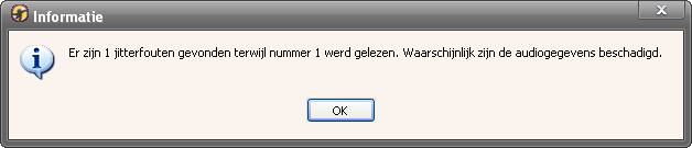

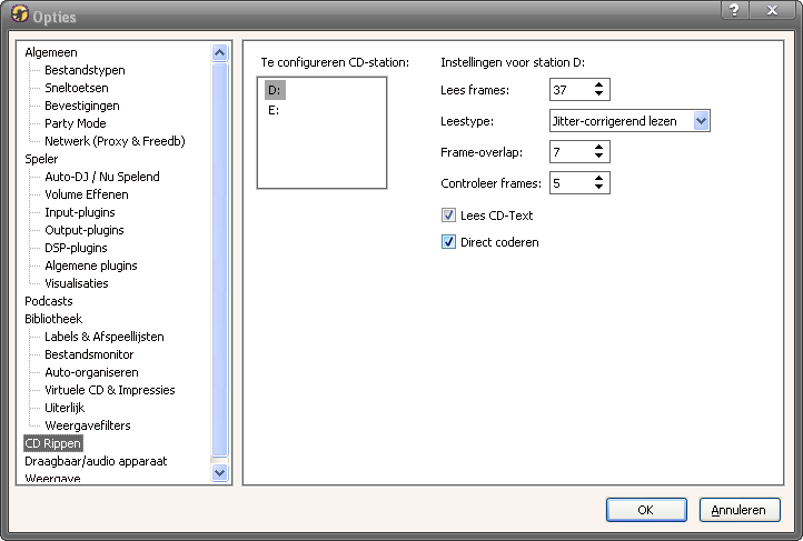

And i would like to say that the new Mediamonkey has a rip possibility with a Jitter correction function ( Whatever they mean by that? ).

They have much better integrated  security features. I also think they have a much nicer UI.
MediaMonkey:
What kind of jitter reduction is that supposed to be? The only time you'll get jitter on the CD is while
you record it or if you do realtime playback from CD.
There is no jitter involved while you write the data to a file.

Well i think they mixed up a few things and named it wrong... When EAC found a bad spot on a cd they find it also but than they say that they found several Jitter mistakes and that probably the audio data is damaged.
