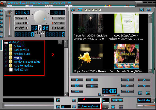

I have some trouble to get the right setting (view)to the gallary(C:\) in the left pane (see attachment). It always happens when i add new tracks to the Gallary. When i add new tracks i change the path (via library button) to the drive containing the last added rips (I:\). With the right button i add the tracks to the Gallary.
1 How to get the right path C:\Gallery in the left pane. I have set the Music route. Is there a simple way to correct this?
2 When i want to correct the wrong spelling of "Gallary" in the path name i used, can i simply correct this by changing the name and path name. Or do i need to change more?
3 Sometimes when i add new tracks in the library (Gallary) i saved them by accident in the original place where the tracks are! Stupid but it did happens more than once. Is it possible to send a warning message "Not a vallid Gallary" ? I have set a music root.
Regards Johan

« Reply #1 on: February 13, 2011, 05:08:30 pm »
This is on my list already. Most annoying that it isn't there (anymore actually). Happy
You just can't do it I'm afraid. But :
On my list too is a sort of "change" function for when Driver Letters have been changed. That will allow for this just the same (when done).
I can imagine that this happens, yes. Such a check should be easy to add.

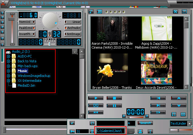

« Reply #4 on: February 15, 2011, 12:13:41 am »
1 How to get the right path C:\Galerie in the left pane. I have set the Music route. Is there a simple way to correct this?
Found it! Change the path (see 1 in attachment) in mine case in C:\Galeries and close and restart XX then you get the right Gallery view in the left pane back (2).

« Reply #5 on: February 15, 2011, 09:13:23 am »
Hi Johan,
Although your attachments didn't come through as intended, I know what you mean. Btw, *I* always do it by means of a Saved Gallery Result and get that back. So, make one of your c:\Galleries and get that back when needed. Is also infinitely faster if you have somewhat more albums. But still "handling" which wasn't there before ...

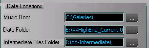

« Reply #6 on: April 09, 2011, 08:54:13 am »
Doh ! I just wanted to make something for this, and now it appears to be in there already ! See below (this is after rightclick the empty area in the left pane).
