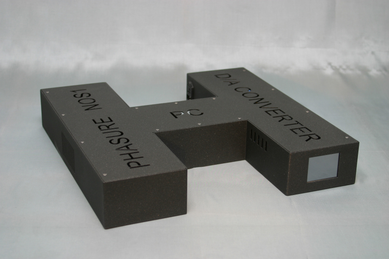

The Phasure NOS1 24/768 async USB D/A Converter again defines new standards. Not only the technical level is up to the extreme, but sonically it superceeds the original Phasure NOS1 by far. And that was already considered to be the best ...
Thinking about the explicit Sound Quality Control always incurred for by the XXHighEnd software, we are now greatly proud to anounce that all what could be done so indirectly in PC software before, can now be done directly in-DAC. A world's first once again !
Although at this moment the DAC operates with the best sonic settings we could find, the firmware -which directly controls the hardware- is upgradeable in a whimp. And, like with XXHighEnd, more versions of it could be readily available on your computer, you picking the best sounding one. Changing the firmware is nothing more than reconnecting the DAC to the USB cable ...
With the knowledge of XXHighEnd and SQ control, together with the development experience of the original NOS1 - at last it was achieved that the software influence has been eliminated. SQ Controls in XXHighEnd won't do a thing to the sonic performance of the new NOS1, as won't different software sound different anymore (no Digital Sound Processing assumed to begin with).
It is to be kept in mind though that the Phasure NOS1 async USB requires external filtering, so it is there where software still will matter. But, this is completely intentional (and is a form of DSP).
The NOS1 USB will work on any MAC just the same, but here too it is to be kept in mind that the external filtering is required for Redbook material. This is not the case for HiRes where all filtering just should be out of the way. On this matter the NOS1 does not contain any filtering of any kind, so its inherent impulse response (which is the mimimum of one sample long) will uniquely 100% show you what HiRes really brings.
An optional Direct DSD/DSF (no conversion to PCM) input is due shortly as a user installable add-on board.
Where the original NOS1 already was fameous for its accuracy, the NOS1 USB dives into a whole new world of that. You will be shocked about the detail coming from your regular favorites. Basses will be basses like never before (including the original NOS1) and even at breaking in it will be noticed that no woman voice is able to go wrong ever anymore. The high frequency output has increased to a virtual crazy level, with the notice that here some break-in is needed (approx. 14 days).
After that, distinguishing from live performers in your listening room will be the most tough. The sizes of instruments will show as never before. A piano sounds like a real piano. A sax can't go wrong. 60's recordings suddenly appear to be the best ever. The effortlessness of it all ...
Again assuming no preamp will be used (which is the explicit advice), a more than average good playback chain is assumed. This is related to the sheer speed of transients, and the requirement of the chain to be able to follow that. Without this, the sound may become somewhat aggressive.
The NOS1 USB is targeted on the highest degree of audiophile music reproduction through loudspeakers, so most probably it will be allright - assuming all is aranged for to the best of knowledge anyway. Still, there is the usual 90 day money back guarantee just in case it isn't working out (Edit : see Phasure NOS1 Refund Model).
However, for those experiencing problems in this realm, it is good to know that the beforementioned add-on board will contain an A/D section and with the help of the totally unique XXHighEnd analysis software (sadly not available for Mac) you will be able to create groundpaths for your chain with the least noise. See Measuring XXHighEnd from over two years back to get an idea of what this software can do, which sure is not only about eliminating noise. If you think cables matter, this will show you the truth without any doubts left.

Price of the new NOS1 USB in standard blue colour powdercoat (see below picture) 2ch RCA+XLR Out : 3320 euro ex vat and shipping.
Price of Upgrade from the original NOS1 to NOS1 USB : 335 euro ex vat and shipping.
Price of any car paint (two component) colour (provide a colour code please) : 160 euro.
Price of powdercoat black (picture at the top) : depending on the amount which can be done at the same time, between 125-175 euro. 70 euro. Edit September 23 2011 : We have let done a batch of 25 for the time being allowing this price now. We name it Saturn Black and it is a soft-feeling beautiful finish with small spikes of metallic.
Notice that the first batch of NOS1 DACs do not contain the DC Offset Control and real time Meters; it is adviced to have your NOS1 upgraded to that for 140 euro, when you upgrade anyway.
Price of further extensions on request (because of the efficiency in the various combinations).
Email requests or questions may be sent to sales a@t phasure.com; please denote "NOS1 USB" as part of the title.

« Reply #10 on: July 18, 2011, 12:42:25 am »
All is out now, and way, way more mouth watering than expected !
There was me making evolutionary changes to the Juli@ interface and you were up to your usual revolutionary approach again  Wink
Please put me down for the upgrade as soon as you have capacity.
Posts: 16669
« Reply #11 on: July 18, 2011, 07:59:29 am »
Mani, thank you. We will continue this via email, ok ?
Paul, consider that colour change. You can always tell your wife that this is *the* opportunity to change the colour. Let her pick it, but be careful. Happy
Leo, it is almost not feaseable to wait for it. Theoretically doable but the planning is a bit difficult at this moment. In either case it will take 4 weeks or more to even start thinking about it. Here too, let's continue via email.
Suteetat, as you will have heard we're fighting some stupid double customs duties. Really crazy that there doesn't seem to be a procedure for it. But undoubtedly we will manage.
It is the intention that DSD is going to work without conversion to PCM, but honestly I am working on that one right now and the design is not complete yet.
Power cord is still the same, but the end of the current stock of cases comes in sight. All is solved by a 90 degree angled cord of course, which anywone can or will do, once you're into your own cords anyway. But notice that this too is "in-DAC" impeded, and where before with XLR a slight rise was to be seen under 100 Hz, today this has completely vanished. IOW, where people might think this is because of 50 (or 60) Hz mains influences, it really is not. Or, not from there at the outside ...
Nick, consider your efforts to be beneficial to all, hence the new NOS1. The latter above is just part of it. I think we have been driving eachother to the sort of ultimate. At least I have been tempted to "see" the least noise possible, which is -as often- only the reference of what's achieveable. Next it "only takes" to push yourself to achieve that reference in whatever other situation. This is what happened, and it is exactly this why USB started to work in the first place. Without this ? no way it would have been any good.
For others ... what this came down to in the end to was a design with the least different number of voltages, so no (noise incurring) regulations anywhere had to be applied. This succeeded, although 2 very low current and harmless 1.2 and 2 voltages are still in there. And for your fun Nick : at the very very end (only last Friday) at assembling a first final DAC in this setup, we ran into a small problem I didn't (and actually couldn't) notice myself. A 12V relais which was fed by the old Juli@ 12V linear supply which I still had in my own test DAC. No 12V supply is in the NOS1 USB anymore, and with the solder on the iron we "dicovered" it. A larger problem you can imagine, because no low voltage relais exist for the thicker supply wires it controls (well, not that I could find in fast fashion). I really saw all collapsing, also knowing that no real space is available for another dedicated PSU. But after sitting back for a day I found a solution ...
Thank you Nick, on behalf of all.

« Reply #15 on: July 18, 2011, 01:25:15 pm »
Hi Joachim,
My reservations about USB appeared justified allright because this really won't go by itself. The "problems" themselves didn't change, but my approach did. It is fair to summarize it with two main aspects :
1. Noise which is like (relatively) crazy;
2. Jitter which is higher.
Both are related, because at these speeds (480mbs) no means exist to surpress noise other than incurring for additional jitter. Notice that this is not about audible noise as such (around 2mV), but it influences the sonics heavily (well, listening to the NOS1).
And so I sat down to achieve the 7-8uV from the original NOS1, which again just has been a reference, or IOW "see, that is possible !".
This whole little "project" is about prooving where actually "noise" comes from, and it is here where Nick has been a great help. Not only about looking for even better sonic qualities, but merely about the proof what did NOT help, hence what it all was NOT about. Funnily enough we both worked with the same sources, but onto different applications : Nick with batteries on the Juli@ department, and me with batteries on the USB stuff. We started with this at the same time, but I didn't want to apply it to the Juli@ interface anymore because it seemed the wrong traject. In the mean time though, Nick's sound improved while mine only got worse. It didn't work out, or at least we couldn't find the consistency in it all. I couldn't and Nick couldn't either, both working on a complete diffrerent interface. But here too only one thing seemed important : eliminating all the regulators to be found. Nick's 1, 2, 3, 4 and 5. Maybe 6.
I worked out a complete battery operated design (so, 100% of the DAC including chargers of different types for the different types of batteries, the connections), but noticing the inconveniency of charging (though the whole thing could kept on playing for 48 hours continuously) made me work in the other direction more : achieve noise levels with normal PSUs.
A real strange coorporation which merely looked like sparring to me, but -and I can't say this enough- which for me was about "seeing" the reference, thus knowing what must be achieveable.
And so the USB interface ended up with 7uV (6uV maybe, depending on the soldering quality), even lower than with the Juli@ interface. Notice though that this isn't about noise at the outputs only, but more importantly about jitter influence which doesn't show as noise at the outputs at all. However, the theories were applied throughout, and while I can't let show jitter of any kind anyway, the sonics told me sufficiently it helped, as it did with Nick's. Measurable or not, the jitter must be way lower now because of the crazy difference in sound. Fun is and remains : no difference with Nick, although working on the complete different interface - and keep in mind, the exact same DAC.
Will you recognize your music ? I guess so. But somehow you won't recognize your listening room ? What you will not recognize is the basses. Not only the upright ones (they are just live now) but also the stiffness of electric ones. Oh, that already was so good ? well, it could be better. This too is just jitter again, no matter how low it is or was.
USB3 ? I wouldn't know why. There's 8x 32/384 (24/384 output) and it really is enough. It would only allow 8x 32/768 as an addition, but more has to change because the on-board processing will have ran out of bandwidth then. Also, keeping in mind this is all meant to be an 8ch XOver, 768 will be too much for everything. Well, that's what I estimate.
September/October ? yes, there should be sufficient stock then. And if not I'll have reordered.

Posts: 16669
« Reply #26 on: August 09, 2011, 10:11:46 am »
To those waiting ...
Except for one, nobody really knows - but during the stage of getting the first NOS1 shipped a few things happened ...
I'm talking about the day I created this very thread, being confident that all was good to go. Ok, not enough stock to really satisfy all soon, but I knew that and I told about it.
The first NOS1-USB really was completely ready; it was measured and everything, and we were about to book it for shipment. But suddenly there came a message from someone (haha) owning two NOS1's, and both exhibited the same offset change, going from day one to day two. This combined with other experiences, and I said to myself, till here and no further. The story is much longer, and in the end is related to our mains systems and house grounding. Never mind this for now. But I wanted to definitely solve it. And not to forget : NOT by means of something in the signal path ... (how difficult can one make it for himself scratching).
After a search of two full weeks - soldering in and out and back again, SMD stuff and chips and everything - I was as far as two sections on the gain stage possibly influcencing eachother in an illegal way (not that electronics or simulations could proove that), that impeded by whatever groundloops coming from external.
In the mean time, we already found that we were able to create the offset just by hovering the NOS1 like reaching for switching it on ... However, one person could incur for that, and the other could not. The difference was in the shoes (isolating rubber vs. not isolating). Ok, it's not a strange story by itself that "we" guide current to earth, but part of the long story is that once a ground loop is setup like this, you can't get rid of it anymore. So, it is you who incur for the loop, but the loop goes through the DAC and stays. This is all in very brief ...
After tearing down really every part of that new NOS1-USB we expected a possible culprit to be in two "fighting" parts of the gain stage, and so I set myself to eliminate those two parts into one only; no fight possible with one part.
Well, in the spirit of Nick's activities again, this part which could be eliminated is a part which creates 2.5V out of 5V. This is a shunt regulated section consisting of some chips and transistors, and if you think of how a "shunt" operates, yes, this is prone to misery (you can't even see that things go wrong because of the ever the same voltage and actually same current flowing).
Of course the transfer to 2.5V was there for a reason, so that reason had to be changed / eliminated.
In brief again, I managed. Took days of reading datasheets at finding the suitable parts, preferrably all fitting the existing PCB or otherwise hell would break loose on redesigning that - reproducing that (preferrably in test first) - waiting for all that. But this turned out not to be necessary.
As Nick will know, I already was hunting for letting all run on exactly one voltage only, and this is exactly what is happening at this moment. And the big fun : the 7-8uV output noise has decreased to the 6uV range. Haha.
I know, people declare me crazy, but since I'm saying that noise rides ON the signal, and is not under it, it must be a good thing. And in the end you could say that there's 15% less output noise now, which seems a large figure to me.
I'm 100% sure it is audible as well, and at some strange "level" new details pop up. This is so audible that my partner in crime here told me that distortion was exhibiting from a certain familiar track, while really it is in the music itself (and no distortion, but a very fast on/off synthesized sound). So, things look to be faster once again. Btw, an example would be the Mini Moog from Rick Wakeman on Journey to the Center of The Earth and the higher pitched tones. This now is pure on/off sound, while at first it merely was a fluent synth sound.
The mechanism to avoid the ground loop -which is that 140 euro upgrade- actually can go now. Also for the 110V systems where it was created for. However, it will stay in, because in the mean time it's a provision to keep the PSU "hot" while the DAC section is (can be) shut off.
Also nice to know may be the fact that the rails for the output stage now indeed is +/- 5V while 2.1V (+/-) only is needed, and although before there was 0.4V headroom on the 2.5V rails (for overshoots) now there's headroom which never will be utilized.
In the mean time we are out of other stock, this time on ready gain stage PCBs. Well, that happens when you prepare a bunch while afterwards they need to be changed. At least today all the new parts for it will arrive, but it remains a little set back at changing the existing ones, which is a necessity because we're out of fresh PCBs. Wat a laugh.
All 'n all it has been taken longer than planned to get this really rolling, but at least I am glad that no single NOS1-USB has left with "older specs".
In the mean time a possible DC Offset problem (wearing around in two ghost hunted English houses with a leakage to one in Norway) now is history. I sure am glad about that.
