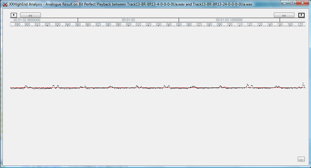

First let's see what's in that 80 seconds 16/44.1 file :
There are 80 x 44100 = 1,764,000 samples for one channel. Note all measurements are about one channel, which just is sufficient (for this purpose and for now).
To my findings so far, when a random *same* situation is compared, around 82% of the samples will be equal.
This means that for our example around 317520 samples are not equal.
Keep in mind that the maximum value in one sample (for one channel, 16 bits) is 65536, but that any situation which is officially equal will have a maximum off value in any sample of 1 (and more rarely 2). This gives an off value of 317520.
See below Compare02 for an example.
These ratios apply always and spring from general phenomena not under our control, but count for my DAC in this case. It will depend on things I currently don't know, but I have a most strong feeling somehow the clock of the DAC is influenced. I derive this from everything I saw at comparing and the patterns I saw. There is more to it though like the receiver chip, and of course jitter coming from the SPDIF connection I used.
If you take jitter as the example of something not being under our control (once the DAC is there), it is an explanation of not every run at comparing the exact same settings, ending up with the same figures. So keep in mind : at running the same settings, only 82% of samples will be the same, and the off value in one sample will be 1 only. I assume this is inaudible when you run a track twice, of which I just have proven it will not sound the same, because it just doesn't come out of the DAC the same.

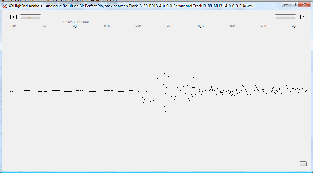

What do you see when the settings are different ?
Simple : the percentage of samples being the same goes down, and the off value will rise. But there is a very profound other difference :
The off value per sample will be higher than 1 for many samples.
See below Compare03 for an example.
I'll spare you the longer list for now, but this is from a relatively mild difference in settings, and the percentage of samples the same dropped from 82% to 81% only, but the off value rased from 317520 to 361724.
This is a mild difference, but something more bad is going on : it happens in patterns. So what you see in Compare02 recurs throughout, and no matter how small the increase of the value per sample is, it recurs every few ms and it will imply an audble frequency by itself (think about dither and why it should be random and you'll understand).

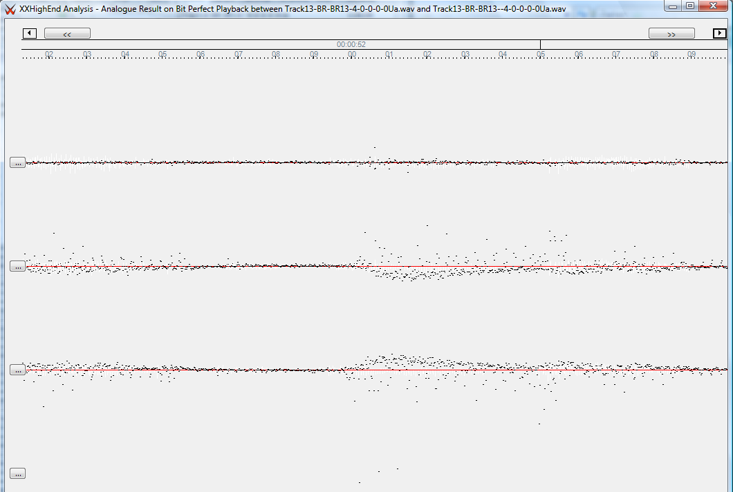

Compare04 below shows a much more severe case;
Here the number of samples equal dropped to 40%, and the total off value rose to 1,980,277. This is not only because the spikes are deeper, but merely because of a more consistent off value, which you can see in the screenshot (the parts without spikes, but with a consistent +++ etc.).
Keep in mind : this is bit perfect. swoon
I have seen cases comparable to Compare03 but worse, which are beyond my capability of explaining so far. There's rows and rows and rows with the value just being of in a rather consistent fashion. It seems that something can get confused and won't recover for a while. But, it always does ... until it happens again.
Not to forget : when I'm talking about things getting confused, this has to be seen in the context of the phenomenon happening, can be repeated over and over. With this I mean, that the specific comparison of two (settings) situations showing this, do not show when the two files recorded from that same setting causing it are compared. Then it's just the known 82% of samples being the same, the others being off by a value of 1 (and rarely 2).
So whatever it is causing this, just can be repeated. Of course this is just the Q settings, or the player for that matter.

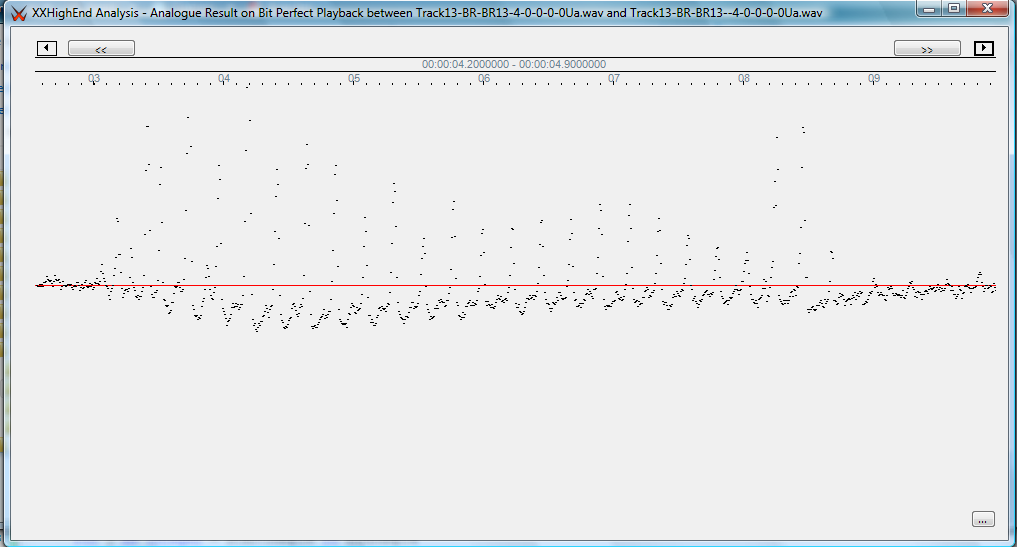

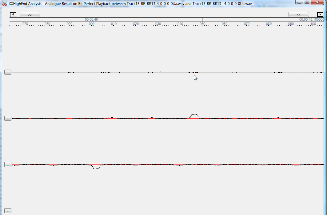

Well, I must say I'm a little proud on this. Long from finished, but here's something for teasing :
05 is a part of 0.7 seconds from the difference between Q1 = 4 and Q1 = -4;
06 is a part of 0.3 seconds from the difference between Q1 = 4 and Q1 = 24.
Unattended, other Q sliders at 0.
Both snapshots are not throughout like that, but they are characteristics for the difference.

It is obvious from the above pictures, that Q sliders influences the sound and it is not placebo the differences that we all hear.
So with this technique you can visualize the relation between 2 different bit perfect Q settings. It is useful for finding some similarities between those settings, but how can this help to find the most accurate reproduction of sound? Is it possible to compare the results, in relation with the digital data before get inside the dac?
M$ Server 2008 R2 Datacenter x64 engine3 / Q1=-3/ Q2=8 / Q3=24 / Q4=0 / Q5=0/, V=-12 Arc Prediction Upsampling x2,sfs=200,SFS.ini=2.1 Thread Priority Realtime -> onboard Realtek ALC889 SPDIF Coaxial-> 8x TDA1543 Nos Dac -> Earmax Pro Amp -> Senns 650

Is there anything showing Q positions influencing 'phase' changes?  It seems to me that phase changes occur when messing with the Q sliders.
« Reply #8 on: April 30, 2009, 07:11:42 am »
Yes Dave, and you can actually see that in both above pictures;
The red line is how things should be. Everything above it deviates to plus voltage, everything below it to minus. And since there are patterns, who knows how this is perceived. Oh, note you see one channel only.
I think I saw my DAC switches absolute phase, btw most do. So whatever you want to see in the above, think about that.
But it is a good remark/question about that phase thing Dave. I already forgot about it, did not look at these pictures with that in mind, but indeed below a certain setting of Q1 we have always felt "phase change". "We" = many.

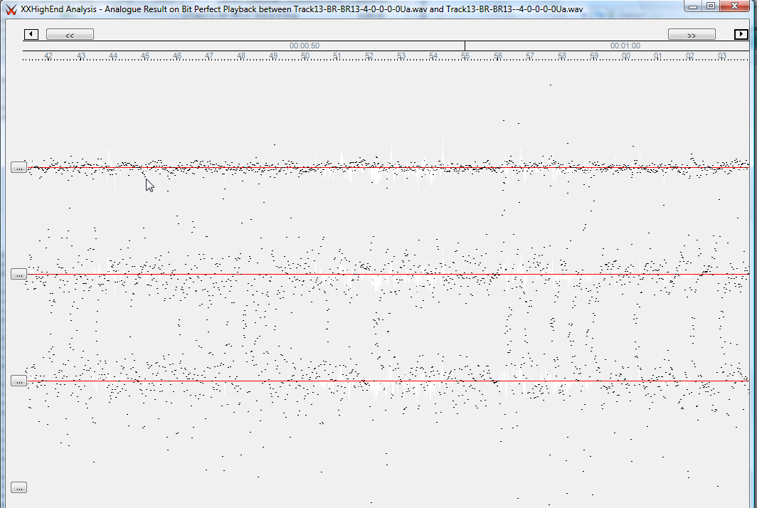

« Reply #14 on: May 01, 2009, 12:26:16 am »
Your both wish is my command ...
Below you see (don't look at the window title !) :
(1) 1st trace 4-0-0-0-0 Unattended compared to Foobar WASAPI;
(2) 2nd trace -4-0-0-0-0 Unattanded compared to Foobar WASAPI;
(3) 3rd trace 4-0-0-0-0 Unattended compared to -4-0-0-0-0 Unattended.

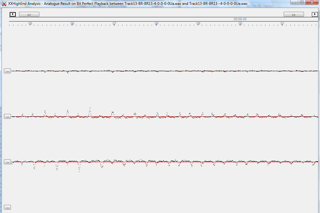

Sidenote : The white graphs are the transients, as taken from the first (left one) mentioned. Generally they are the same for each trace because it isn't about that. However, it may look logical that anomalies in the DAC are cause by high transients. I could not prove this though.
Some notices (beyond the pictures you see, so trust me) :
a. (2) and (3) seem to be of opposite phase, which most likely is because of different offsets used. Strange explanation, but right now I have no other. Otherwise (2) and (3) are very similar.
Try to imagine the phase-change-thing, and that the base of (2) and (3) is -4 vs. +4 (the left one mentioned is the base).
b. If you look very carefully at the first trace of the first picture below (Compare09) you see that where the mousepointer is a "1 cm" repeating pattern occurs throughout. This is fragile, and note you're looking at a time span of 20 seconds here !
c. Compare10 has zoomed in (time span is now near 2 seconds) and with some imagination you can still see the pattern in the first trace.
d. While both (2) and (3) incorporate Q1=-4, you can see it masks all, and makes comparisons worthless. Keep in mind this is my DAC !
e. Compare11 is generally showing that some consistent thing is going on in my DAC; Where the mousepointer shows, right below you see the same but expanded (this is Q1=-4 doing that !), while the third trace shows exactly the same though in opposite phase, but dead sure again Q1=-4 doing it. If you look closely at the (1), (2), (3) above, you see there is no common denominator (none of the three elements, -4, +4, Foobar is in each of them), so my DAC must be doing this by itself. However, it is emphasized or it is not (like in trace 1 it is not).
f. Knowing that Q1=4 seems more reliable, Compare12 the most clear shows that in between Q1=4 and Foobar a pattern is present. It is mild though.
In a year's time I may have more firm conclusions. Just learning here. blush1
