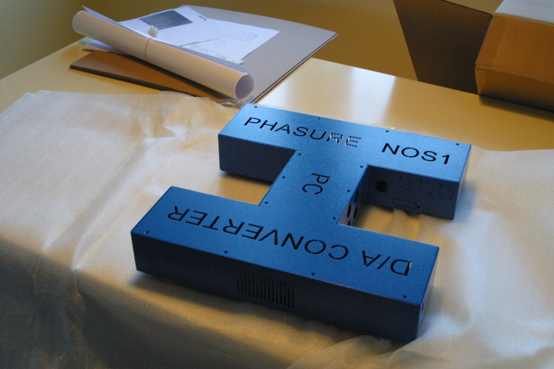

The Phasure NOS1 24/768 async USB D/A Converter again defines new standards. Not only the technical level is up to the extreme, but sonically it superceeds the original Phasure NOS1 by far. And that was already considered to be the best ...
Thinking about the explicit Sound Quality Control always incurred for by the XXHighEnd software, we are now greatly proud to anounce that all what could be done so indirectly in PC software before, can now be done directly in-DAC. A world's first once again !
Although at this moment the DAC operates with the best sonic settings we could find, the firmware -which directly controls the hardware- is upgradeable in a whimp. And, like with XXHighEnd, more versions of it could be readily available on your computer, you picking the best sounding one. Changing the firmware is nothing more than reconnecting the DAC to the USB cable ...
With the knowledge of XXHighEnd and SQ control, together with the development experience of the original NOS1 - at last it was achieved that the software influence has been eliminated. SQ Controls in XXHighEnd won't do a thing to the sonic performance of the new NOS1, as won't different software sound different anymore (no Digital Sound Processing assumed to begin with).
It is to be kept in mind though that the Phasure NOS1 async USB requires external filtering, so it is there where software still will matter. But, this is completely intentional (and is a form of DSP).
The NOS1 USB will work on any MAC just the same, but here too it is to be kept in mind that the external filtering is required for Redbook material. This is not the case for HiRes where all filtering just should be out of the way. On this matter the NOS1 does not contain any filtering of any kind, so its inherent impulse response (which is the mimimum of one sample long) will uniquely 100% show you what HiRes really brings.
An optional Direct DSD/DSF (no conversion to PCM) input is due shortly as a user installable add-on board.
Where the original NOS1 already was fameous for its accuracy, the NOS1 USB dives into a whole new world of that. You will be shocked about the detail coming from your regular favorites. Basses will be basses like never before (including the original NOS1) and even at breaking in it will be noticed that no woman voice is able to go wrong ever anymore. The high frequency output has increased to a virtual crazy level, with the notice that here some break-in is needed (approx. 14 days).
After that, distinguishing from live performers in your listening room will be the most tough. The sizes of instruments will show as never before. A piano sounds like a real piano. A sax can't go wrong. 60's recordings suddenly appear to be the best ever. The effortlessness of it all ...
Again assuming no preamp will be used (which is the explicit advice), a more than average good playback chain is assumed. This is related to the sheer speed of transients, and the requirement of the chain to be able to follow that. Without this, the sound may become somewhat aggressive.
The NOS1 USB is targeted on the highest degree of audiophile music reproduction through loudspeakers, so most probably it will be allright - assuming all is aranged for to the best of knowledge anyway. Still, there is the usual 90 day money back guarantee just in case it isn't working out (Edit : see Phasure NOS1 Refund Model).

Price of the new NOS1 USB in standard blue colour powdercoat (see below picture) 2ch RCA+XLR Out : 3320 euro ex vat and shipping.
Price of Upgrade from the original NOS1 to NOS1 USB : 335 euro ex vat and shipping.
Price of any car paint (two component) colour (provide a colour code please) : 160 euro.
Price of powdercoat black (picture at the top) : depending on the amount which can be done at the same time, between 125-175 euro. 70 euro. Edit September 23 2011 : We have let done a batch of 25 for the time being allowing this price now. We name it Saturn Black and it is a soft-feeling beautiful finish with small spikes of metallic.
Notice that the first batch of NOS1 DACs do not contain the DC Offset Control and real time Meters; it is adviced to have your NOS1 upgraded to that for 140 euro, when you upgrade anyway.
Price of further extensions on request (because of the efficiency in the various combinations).
Email requests or questions may be sent to sales a@t phasure.com; please denote "NOS1 USB" as part of the title.

« Reply #10 on: July 18, 2011, 12:42:25 am »
All is out now, and way, way more mouth watering than expected !
There was me making evolutionary changes to the Juli@ interface and you were up to your usual revolutionary approach again  Wink
Please put me down for the upgrade as soon as you have capacity.
« Reply #11 on: July 18, 2011, 07:59:29 am »
Mani, thank you. We will continue this via email, ok ?
Paul, consider that colour change. You can always tell your wife that this is *the* opportunity to change the colour. Let her pick it, but be careful. Happy
Leo, it is almost not feaseable to wait for it. Theoretically doable but the planning is a bit difficult at this moment. In either case it will take 4 weeks or more to even start thinking about it. Here too, let's continue via email.
Suteetat, as you will have heard we're fighting some stupid double customs duties. Really crazy that there doesn't seem to be a procedure for it. But undoubtedly we will manage.
It is the intention that DSD is going to work without conversion to PCM, but honestly I am working on that one right now and the design is not complete yet.
Power cord is still the same, but the end of the current stock of cases comes in sight. All is solved by a 90 degree angled cord of course, which anywone can or will do, once you're into your own cords anyway. But notice that this too is "in-DAC" impeded, and where before with XLR a slight rise was to be seen under 100 Hz, today this has completely vanished. IOW, where people might think this is because of 50 (or 60) Hz mains influences, it really is not. Or, not from there at the outside ...
Nick, consider your efforts to be beneficial to all, hence the new NOS1. The latter above is just part of it. I think we have been driving eachother to the sort of ultimate. At least I have been tempted to "see" the least noise possible, which is -as often- only the reference of what's achieveable. Next it "only takes" to push yourself to achieve that reference in whatever other situation. This is what happened, and it is exactly this why USB started to work in the first place. Without this ? no way it would have been any good.
For others ... what this came down to in the end to was a design with the least different number of voltages, so no (noise incurring) regulations anywhere had to be applied. This succeeded, although 2 very low current and harmless 1.2 and 2 voltages are still in there. And for your fun Nick : at the very very end (only last Friday) at assembling a first final DAC in this setup, we ran into a small problem I didn't (and actually couldn't) notice myself. A 12V relais which was fed by the old Juli@ 12V linear supply which I still had in my own test DAC. No 12V supply is in the NOS1 USB anymore, and with the solder on the iron we "dicovered" it. A larger problem you can imagine, because no low voltage relais exist for the thicker supply wires it controls (well, not that I could find in fast fashion). I really saw all collapsing, also knowing that no real space is available for another dedicated PSU. But after sitting back for a day I found a solution ...
Thank you Nick, on behalf of all.
