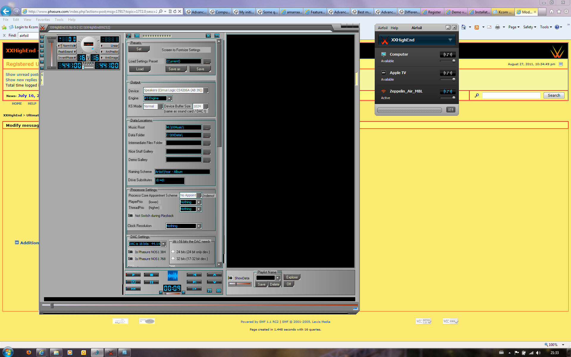

What I am trying to do is use XXHighEnd as a HiQ player, for its legendary SQ, but wirelessly send its output to another piece of software called Airfoil. This allows me to 'send' the data stream to my modest Zeppelin Air integrated system. This works perfectly with iTunes, with any browser streaming MOG music selections, with Foobar and with Media Player etc, so the method itself works wonderfully with these other applications. Now, I do not expect staggering quality from the Zeppelin Air, but it's my first foray into PC based replay, but so far it has worked extremely well for me, hence my interest in improving things by moving from standard players to XXHighEnd .......but, oh dear, it doesn't seem to work with your application so far. I therefore suspect that either my installation is not set correctly or it's not going to work with Airfoil anyway. After installing successfully and playing tracks using the standrad speaker output, I started Airfoil to see if their app could work.  Airfoil can 'see' the XXHighEnd application, but I can see from it's interface  that it's not receiving any output from XXHighEnd ..... result ...... my internal speakers work fine on my laptop but no sound comes out of the Zeppelin Air system when I attempt to get Airfoil to grab XXHighend's output.  unhappy
Attached is a screen shot from my system showing the XXHighEnd UI and the Airfoil interface while a track is playing - you can see there is no 'signal' at the bottom of the Airfoil app as there usually is and the sound is still coming out of my laptop speakers where it would by now be coming out of the Zeppelin Air system with other players!
Would you possibly have any suggestions? I am using the demo installation only to see if this whole thing works befreo buying a license.
Rather disaappointed, but hopeful, Mike
* Full Screen Dump Showing XXHighEnd and Airfoil.jpg (427.33 KB, 1920x1200 - viewed 1719 times.)
« Reply #1 on: August 28, 2011, 01:28:01 am »
G'day Mike and  Welcome !
Peter will be along in a few hours with a thorough answer, but I'm reckoning, that because XXHE runs in what's known as "exclusive" mode, it is prohibiting the Airfoil app from getting anywhere near the data/processing. It's unlikely iTunes is using this exclusive mode, which is why that works for you.
Stick around regardless if you can't use XXHE as initially hoped. I'm sure you will hear the benefits used in a normal manner.

« Reply #3 on: August 28, 2011, 08:36:51 am »
Dear Mike,
I am so sorry that your "first" attemps to make something of today's digital offerings don't work out as intended.
But Russ is right, look here :
http://www.rogueamoeba.com/support/knowledgebase/?showArticle=AirfoilWinWASAPI
(I only have no clue what option C in there means, but I guess that says "don't use it" scratching)
For XXHighEnd indeed only Exclusive Mode is possible. This means WASAPI (Engine #3) or Kernel Streaming (Engine#4).
Before there were Engine#1 and #2 and they were DirectSound based (option A behind that link), but it really isn't for the better. So, that is about the dreaded "bit perfect" thing bascially, and although it is not the most important of all, I dropped those Engines because of the far more poor sound.
Indeed it will be so that an application like Airfoil won't incur for the best sonic qualities, which is for several reasons. One of it is WiFi which is needed (well, that assumed) which is "devistating" to the sound. Hard to explain in brief, but this is all about what the Operating System has to do in order to get things going. The internal communication with something like Airfoil is one of them, and you really shouldn't apply it were it for the best sound.
But hey, what is the big deal anyway ? I mean, if you can't get this going for what you so nicely intended (and a LOT of nice things can be done via the ApplTV alone !), why not use any other player to your likings for this application ? I mean, if the SQ doesn't matter so much anyway ...
