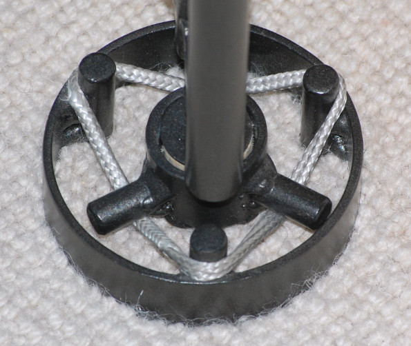

Interesting thread - my NOS1 is supported on string. Well to be more exact it is on a shelf made of pieces of balsa glued together and veneered and that shelf sits on tensioned (but not too highly) chord. I bought this equipment rack primarily for a record deck (pre NOS1 ha ha) and the improvement in sound quality was huge it sounded like the deck had been upgraded to a much more expensive model. That deck had previously been sitting on a very highly regarded shelf on spikes on a concrete floor.
So Mani check out the feet below - I was told at the time that speakers with spikes mounted into four of these feet sound much better. Shame on me I never tried it but looks a bit like Mad Max T's theory.
I have not tried mounting my NOS1 on a normal shelf to compare but I will do and I will also try my speakers mounted on the feet and let you know how it goes. Certainly when I had an AN DAC it sounded much better on "string".
Shown below is the "string" arrangement below each shelf and a "foot" which accepts a spike in the middle (hidden in the picture). The guy who makes these shelves started supplying to the home market and now mostly supplies professional recording studios.
