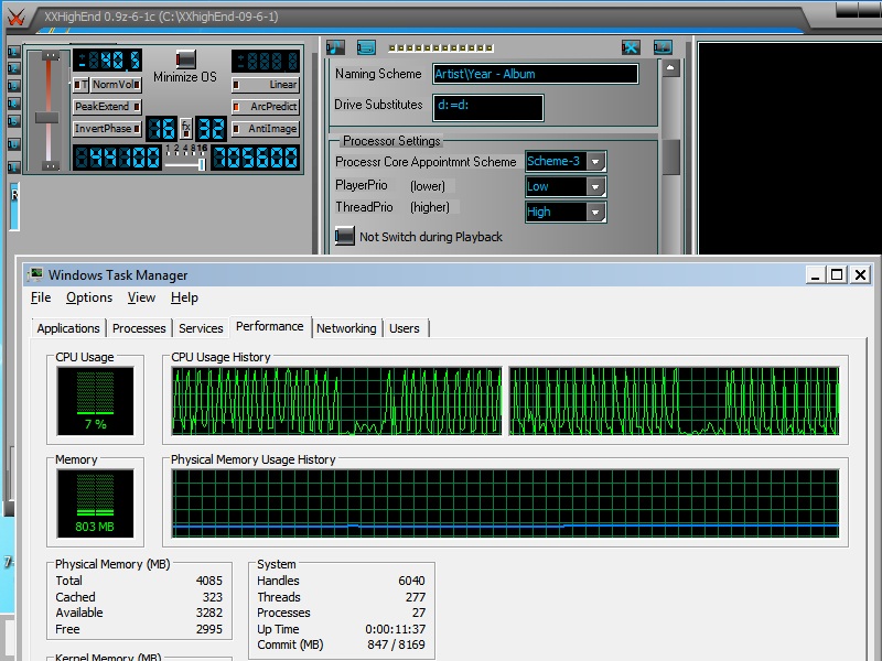

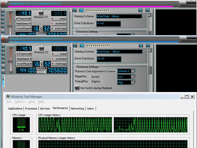

I noticed the processor not being used in a way I was used to. I allways have the taskbar ready to get some insight into performance or SQ problems.
What is happening I illustrate with the attatched pics.
Pic 1 is a picture of XX playing a WAV file with settings as in my signature after a fresh reboot.
Pic 2 is a screenpicture of XX playing a FLAC file directly after the WAV with same settings.
Is this the cause of the difference I have been hearing between FLAC and WAV???
Pic 3 is a screenpicture of XX playing the same wav as in pic 1 after the FLAC of pic 2 (same settings).
The right -wav- part of the processorchart is obviously different from Pic 1.
scratching
Two more things:
- same situation in unattended
- same situation when XXEngine3 is stopped before the "pic 3"
And pic 1 and pic 3 situations sound different!
regards, Coen

« Reply #1 on: December 23, 2011, 11:08:46 pm »
Nice ...
But as far as I'm concerned you are heavily overdriving your system. Do the same after a reboot and the same most probably will happen. But copying the first "pic" somewhere along the line will be the most difficult. So, apples and oranges.
And a way underperforming PC ... (small notebook probably)
yes
Edit : well, it's in your sig ...
« Reply #2 on: December 23, 2011, 11:17:42 pm »
A 'non clipped' pic 1 is how Scheme 3 would look normally, isn't it?
Is there any way to relieve the poor basterd form its cpu burden?
regards, Coen
« Reply #3 on: December 24, 2011, 09:53:57 am »
Hi Coen,
It is the first picture which will not be the normal situation. But, right after a reboot all is different. That's why I think you won't be able to copy that situation anymore, unless doing the same after a reboot again.
So, that second picture and further, things start to get spread over the cores, while the OS should have done that in the first place. But, it depends on what we see here (see below as well).
The "clipping" by itself is allowed, as long as it doesn't take too long (it doesn't here). But what worries me more is that this looks like to come from the USB transfer "blocks", while this shouldn't reach any 100% at all. So, you are close to holding back the USB transfer here.
In my picture you see XXHE in core 1 and the driver in core 8 (also 32/705.6). Where the USB transfer is ? I never saw it.
(this is Attended and Not Minimized, SFS 430, Buffer in Control panel at 2ms)
You may set Q1 to a lower amount to see it change (assumed I am right of course).
If you have set your SFS to 1 or so, it is that what I'm seeing. But if so, setting it higher and all will die.
I am sorry, but this won't be suitable for good SQ means. If you think it is okay, then it is okay of course.

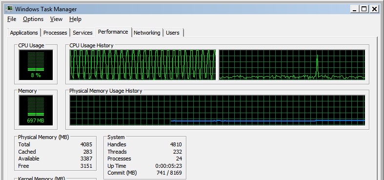

« Reply #5 on: December 28, 2011, 09:10:12 pm »
Ok,
All drivers are updated and the 8 gigs are in and i can push up to an sfs of 144. This increases the time between the peaks, but has a negative side effect of sudden drop outs and skipped (smal) parts of the music. Dropping q1 does not seem to have an effect on the load.
Save for these interruptions of sorts, i think it sounds excellent. Too bad  it doesn't work properly unhappy.
With quad ap things get a lot easier for the pc. A much larger interval between peaks (still there) and a smooth ride through the tracks. Definitely a different kind of sound, all seems a little smoothed over, however very nice by itself.
Any suggestion what could be the matter on the usb side? With my pci soundcard i also had a rythmic peak but only in the 'left' core.
Minimised or not, it does not make a difference of the cpu load.
Quote from: PeterSt link=topic=1909.msg19590#msg19590 datedate=1324716837
Q1 below 15 with quad-ap makes a difference in 'cpu baseload' from  average 7% to 3%. Sfs in pics above is 34...
I will update my signature (nos usb on 12ms and sfs of 144).
Regards, Coen

« Reply #7 on: January 01, 2012, 01:07:04 pm »
Hi Coen,
Well, it seems that you sure "learned" what causes what. And as you will have concluded (I think), it now just is the cpu which is not fast enough to cover for it within the time it is given. But :
Notice that there may be a small contradiction, which is about the hyperthreading being active now, which cuts the core speed in half. So, if that doesn't slow down the process (and it seems to me that it only speeded up), you really must think about the disk subsystem being too slow. Could be USB connected, slow Ethernet, otherwise ?

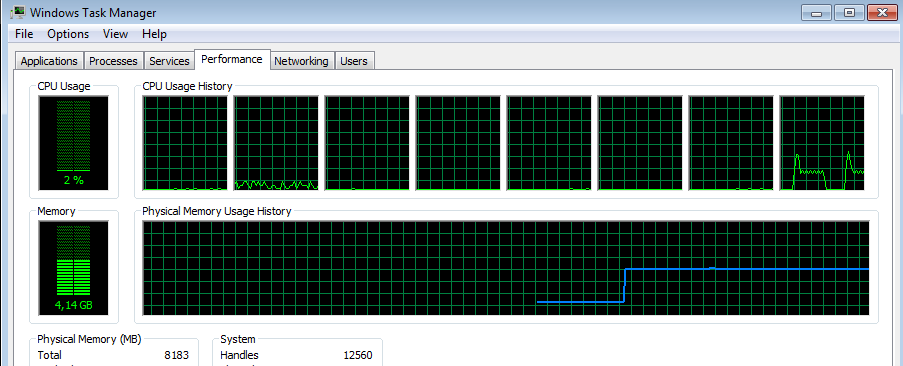

« Reply #9 on: February 13, 2012, 10:23:21 am »
Hi all,
Last weekend I finally assembled my new pc. Amazingly everything worked from the start. What surprised me the most was that win 7-64-ult booted with the new mobo with new processor. I had the wrong setup-boot usb that didn't boot as intended, yet everything on the 'old' w7 install worked fine.
Well, almost everything, since the processorload pattern discussed in this thread is still there. That is the music is loaded with (now very brief) peaks on all cores. I did not expect this to happen since it was believed to be a result of the poor atom performance. This setup is about 10X as potent...
Sq wise the sound is very similar to my old setup, yet a tad bit less relaxed and full. I have to play with the hardware and bios settings and xx setup to get sq on par with what i am used to. Some mobo burn-in may also play a role.
I am very happy with much  improved response of xx. The pc is not completely silent yet. Processor temperature stays very low, i am considering a completely passive setup.
Regards, Coen

« Reply #11 on: February 13, 2012, 11:24:23 pm »
A bit depending-on, I think this is normal.
Try and see whether the interval doubles when you halve the SFS ...
Thanks for the reply,
Well, the interval Halves when SFS is Halved.... (from 220 to 110) iow the frequency of the peaks doubles when halving the SFS... unsure
I guess this is ok.
I reduced the NOS driver buffer to 4 ms and see more activity on the first core.
regards, Coen
