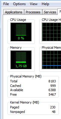

Maybe you have a video card with much memory (addressing) ? I am not sure, but possibly you have to think that each MB it can address, is eaten from the main memory.
A bit difficult is that the SFS can't be directly mapped to consumed memory (not with quite some work on my side), but let's say that 500 equals 2GB somewhere. This means that 400 would be some 400MB (1/5th) less or IOW you'd miss 400MB - hence the video card could consume 400MB more than you want.
Hey, that's a lot of assumptions. But I don't know of anything else, except for maybe not all the memory is seen in the first place. What does the below tell in your case ? (this is an 8GB system, nothing allocated by XXEngine3 at this time)

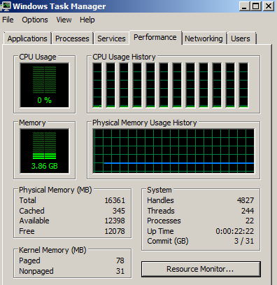

Don't know if this is significant, but i have less kernel memory? Might that be the problem?
« Reply #3 on: May 26, 2012, 04:31:25 pm »
Not that I can imagine.
I said this for a reason. What's your case ? Already allocated I suppose ? Anyway, this looks quite the same as my 430 (which then would have 3.89GB in use).
So, dead end. Better ask someone else.
