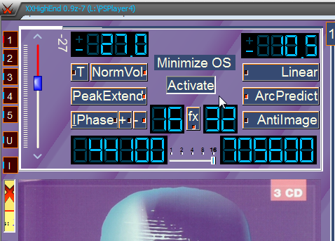

Once you received your Activation Code, click on the Activate field as you see below at the mouse pointer :
Watch out : The Activate field you see will always remain. So, Activated or not, it will stays as it is.

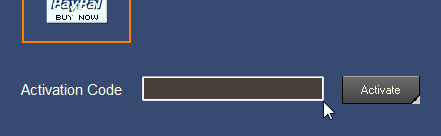

This brings you to the page where you started out before with the PayPal payment.
Copy paste the Activation Code you received by email in the "Activation Code" field and click Activate. Wait until you see the process has been completed (the button pops back and this may take a couple of seconds).

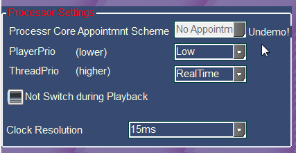

Next, start XXHighEnd again (you can use the Alt-X shortcut for that) and check the Settings Area for a possible "Undemo" tag next to the Processor Appointment Scheme field (this is in the Processor Settings section) :
If there it (still) shows the "Undemo" tag, you're not good ...

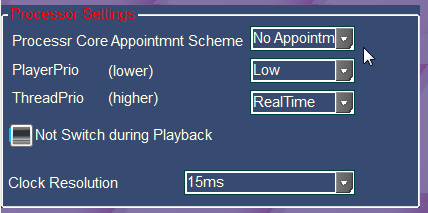

But if it looks like this :
... then you should be okay.
