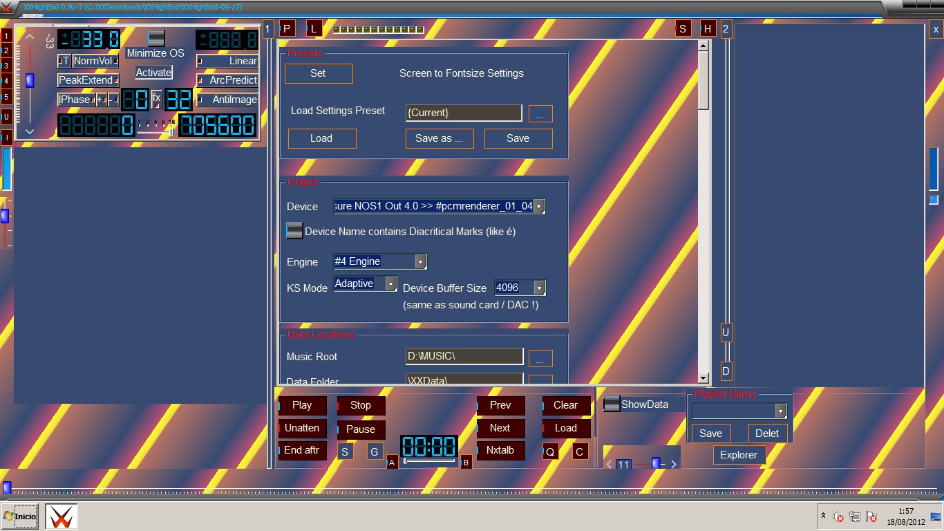

Sorry I have no clear what you mean with "net buffer", is it the Device Buffer or the USB buffer in the Control Panel?

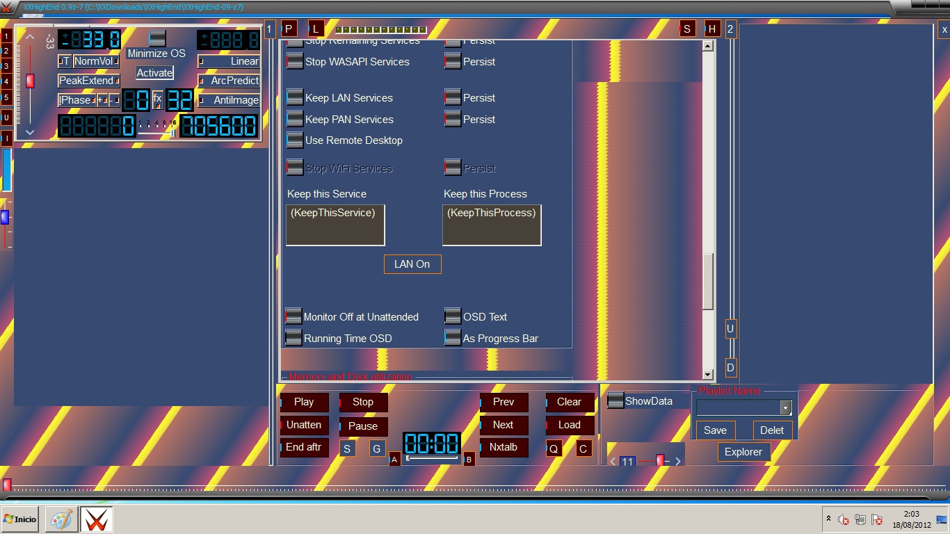

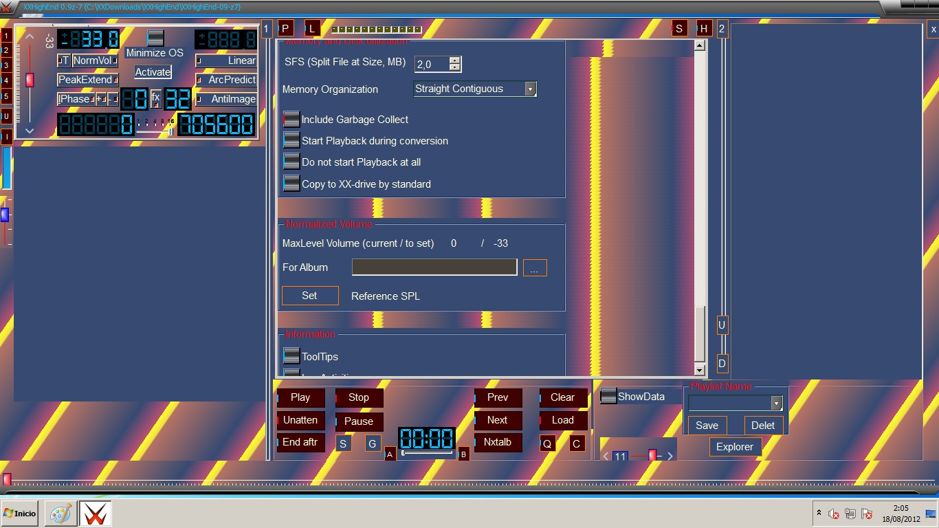

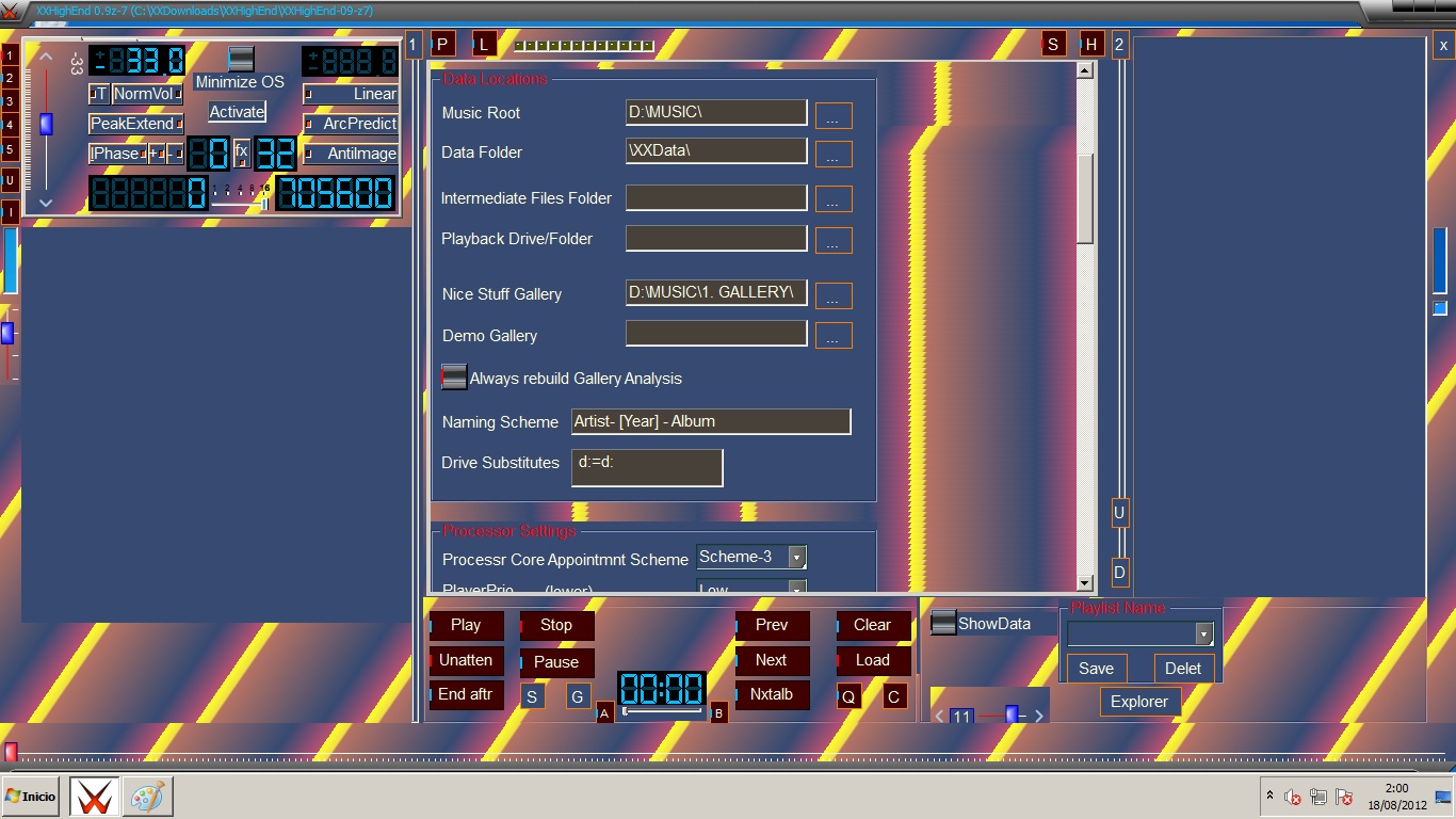

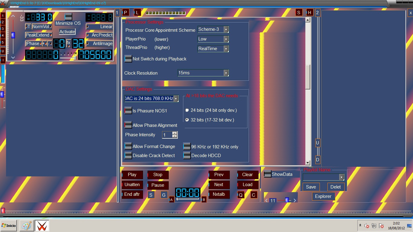

I post here the screens of my settings to see if this way is easier to see if I have some error.

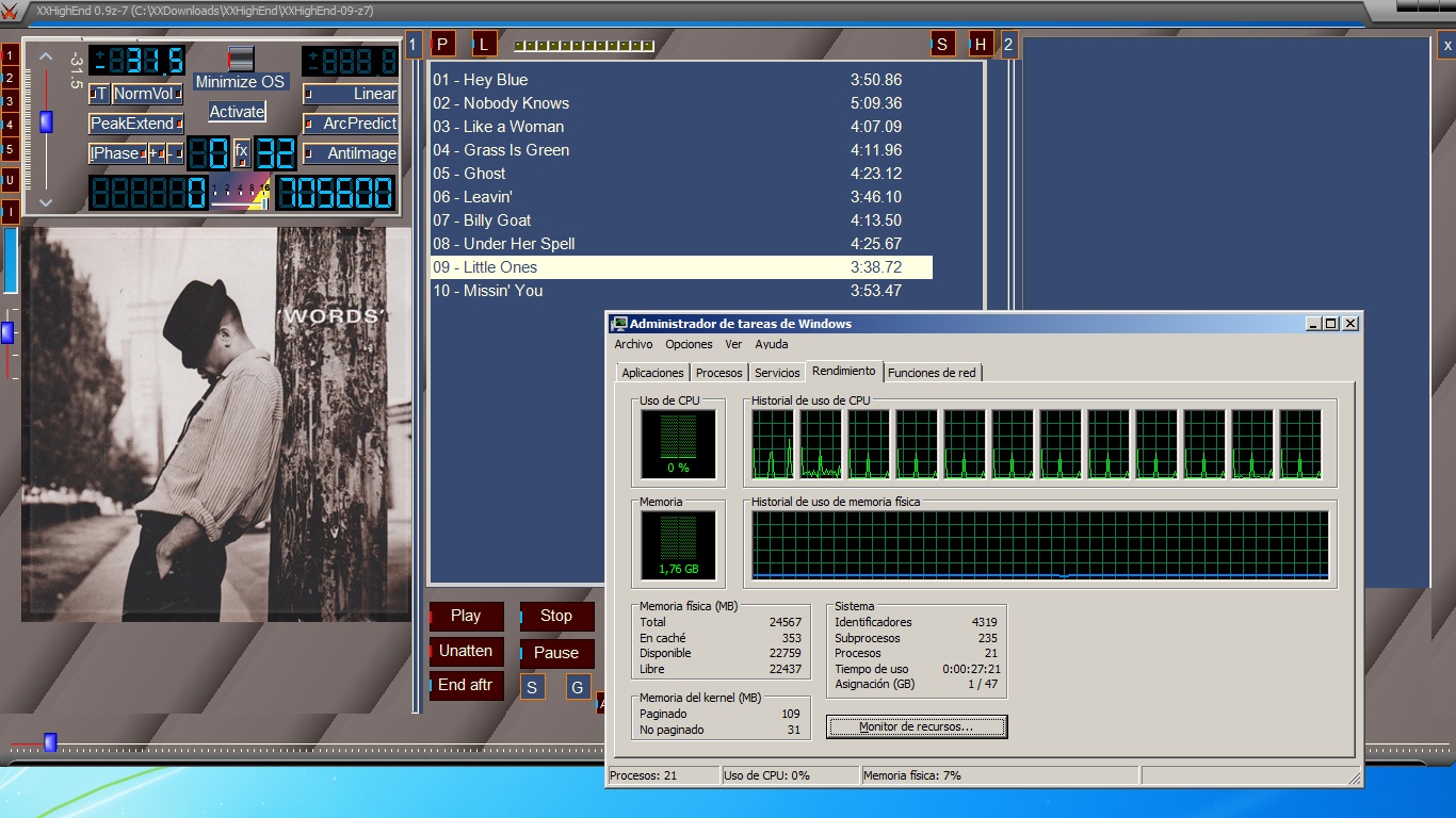

« Reply #5 on: August 19, 2012, 05:37:48 pm »
As I said I have stops and pops when I use the settings that can be seen in the previous post. I can avoid the glitches if I set the SFS to 50, the sound is also great but it seems more accurate with SFS at 2.0
Following the advises of A Guide to Glitcless Playback
(http://www.phasure.com/index.php?topic=2029.0), I´ve started the Task Manager to watch the cpu and memory behaviour, I haven´t seen notorious spikes at different settings as you can see in some printed screens.
At the end in the Guide it is said: "If you hear problems but don't see it on the cpu graph, watch the disk light and see whether it's related."
I don´t understand what disk light is talking about.

« Reply #6 on: August 19, 2012, 06:01:04 pm »
Hey Juan,
If it were for me you are mixing up things now. I mean, first you say that with Playback Drive you have no issues, only at start/stop, and next you continue with "but without Playback drive I have glitches". This does not work for me, because now I don't know what to answer anymore. So, one thing at the time, and I don't think it should be about anything with the Playback Drive in use (and otherwise rebuild your PC because it is clear (to me) that something is not right or on par). So …
With "net" buffer I mean the result of the product of Device Buffer Size, Q1 and Q1Factor. Otherwise see the ToolTip on Q1Factor (I think it is described there). Remember, this is about Start/Stop only, like you brought it up yourself (as actually the only issue).
But about that other issue :
When you hear glitches (or plops with Phase Alignment engaged) ... a disk light is a light which flashes when disk access is happening. Since all is priority related (OS and hardly XXHE), when sound stalls (a plop in your case) during disk access, you can bet that something chokes in that area.
I don't think it is the idea that I now start trying to tune everyone's system, only because someone told that SFS=2 sounds great. I mean, I am not the person to be addressed with such issues. At least I don't think I am. But the least I could do is write this : A Guide to Glitchless Playback. Maybe that helps ?
One hint : I format my music hdds with maximum blocksize for NTFS (64 KB). Did you ? or did you leave it at the default which is AFAIK 512 bytes. Now, divide the two into each other and plainly see it as the factor your disk access is slower than mine FOR THESE HUGE FILES.
One way or the other, hope it helps !
PS: You settings show you have it Off, but anyway better switch Off logging, because it causes quite some overhead on the small SFS. My PC can cope with it, but yours and other's may not.
