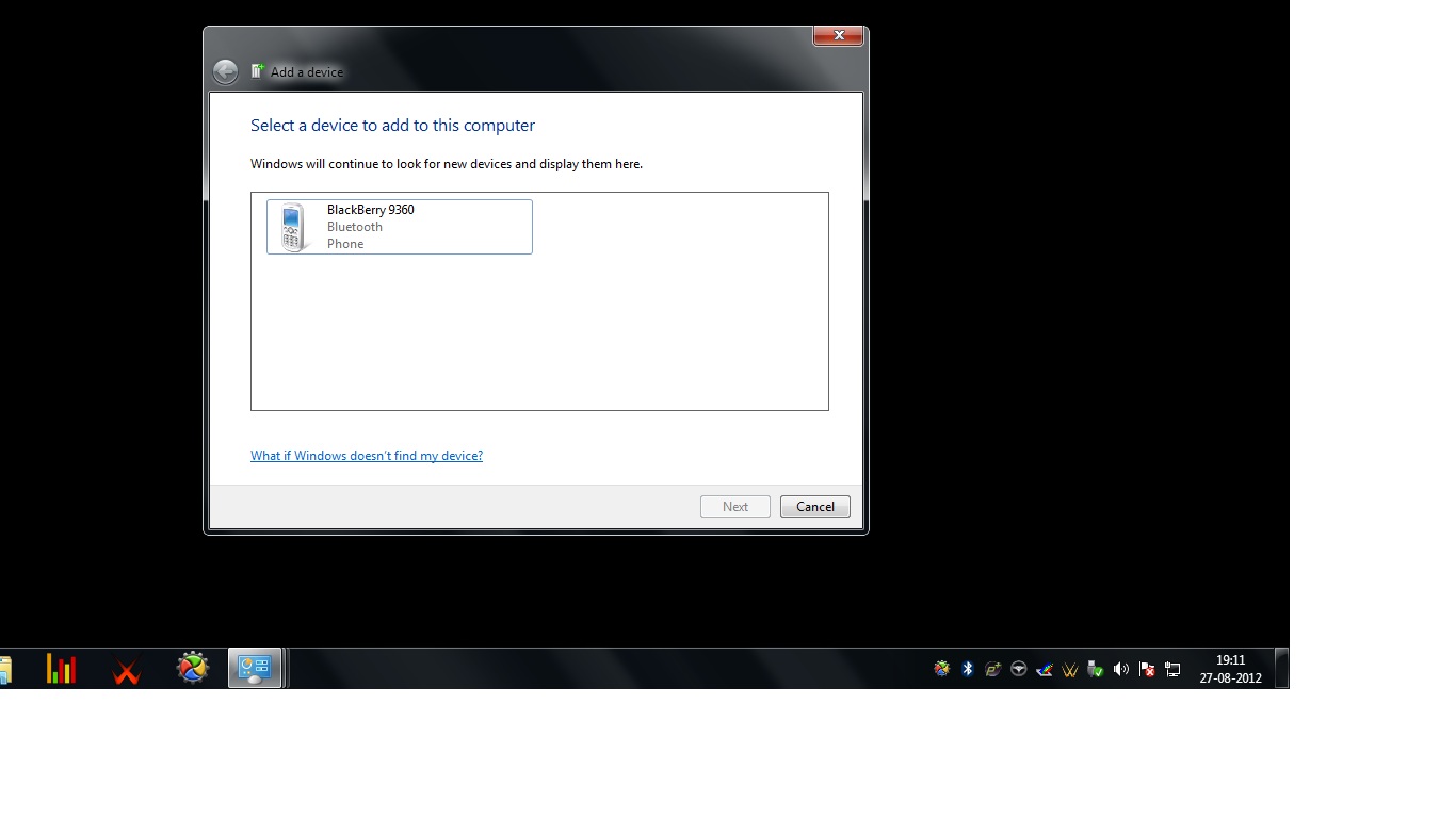

Both dongles blink for some time then the blinking stops for some time & restarts again.
I put on the Bluetooth on my mob phone & both the Audio PC as well as the Laptop discovered the device. (screen shot of audio PC is attached).
Next I interchanged the two blue tooth devices after switching off the Blurtooth from my mob phone. Performed the same again, activated the Bluetooth on my mob phone & once again the Audio PC as well as the laptop discovered them.
So I assume that the bluetooth devices are ok.
However the two computers do not discover each other as yet. Line of sight between the 2 bluetooth device is clear.

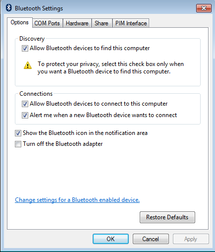

Arvind,
If you go to the Bluetooth icon in the Taskbar Tray (see first picture below, so only *that* icon) and you rightclick on it and choose "open settings" ... are your settings the same as you see in the second picture below ?
All I know is that this is default, but maybe it is not.
Don't forget to check both the PC and the laptop.

« Reply #35 on: August 28, 2012, 03:20:14 am »
The problem in my case was that by default it does not allow A Bluetooth device to connect. Hence I had to tick that & I have managed to connect both devices.
Now I will move fwd in the tutorials. Thanks for the help.
« Reply #37 on: August 28, 2012, 07:59:53 am »
Ok Arvind. Good that you held on !
I will adjust the tutorial for this.

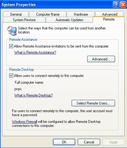

Do you have set a password on the Audio PC ? IOW when you boot it, do you have to login with a password ? This is necessary ...

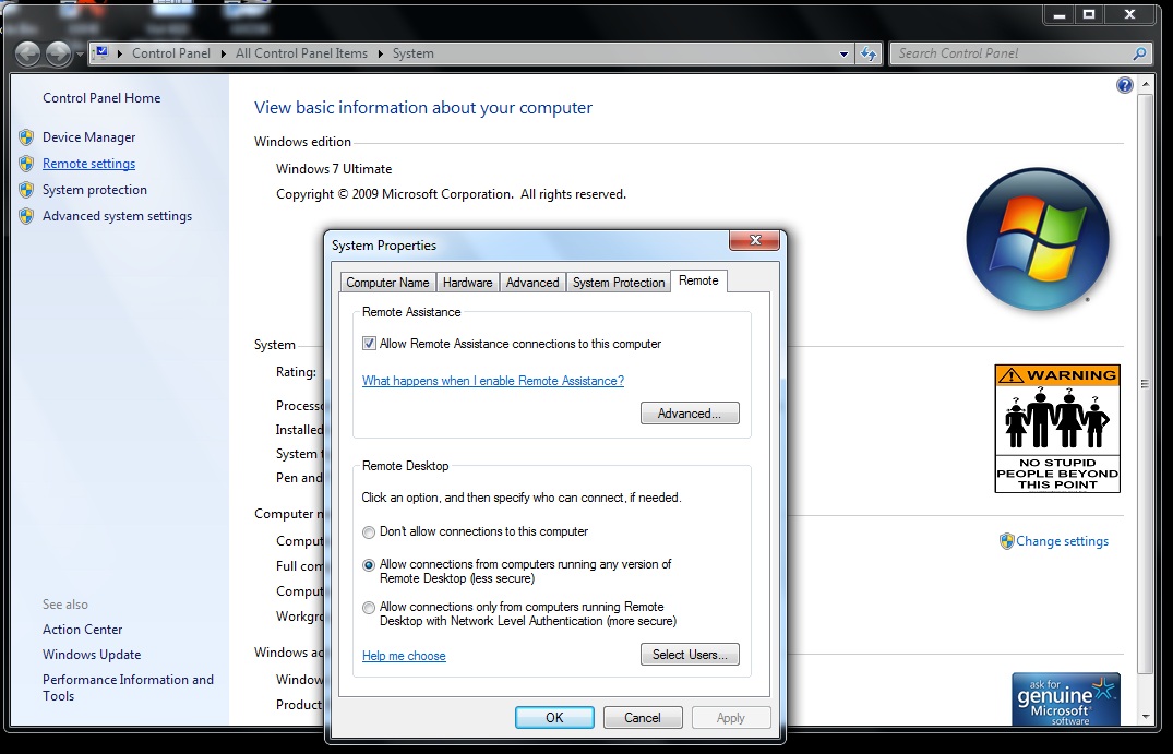

Did you find that page where you can allow remote access ? Look below, but notice this is XP (I don't have W7 around where I am now). Maybe someone else can post a W7 picture - might you be in a hurry. Haha.
Notice that you get to this screen by means of Explorer - Rightclick Computer - Properties.
You don't have to enter anything under "Select Remote Users" and if all is right/normal you also don't need to enter anything under "Advanced". However, check in there whether maybe the allowed number of users is 0 (but I wonder whether this exists in W7).

« Reply #39 on: August 28, 2012, 08:59:05 am »
Happy to oblige.
From the START button, right click on Computer (right hand section) and select "Properties". Then click on "Remote Settings" ( top left area ).
« Reply #40 on: August 28, 2012, 09:01:03 am »
Than you Russ.
And I think I can tell that this middle (chosen) bullet is important ...

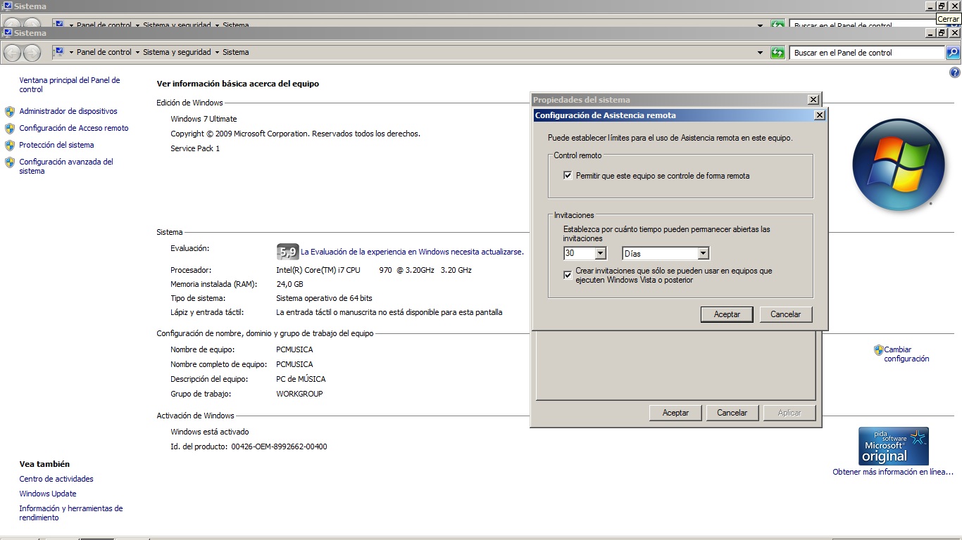

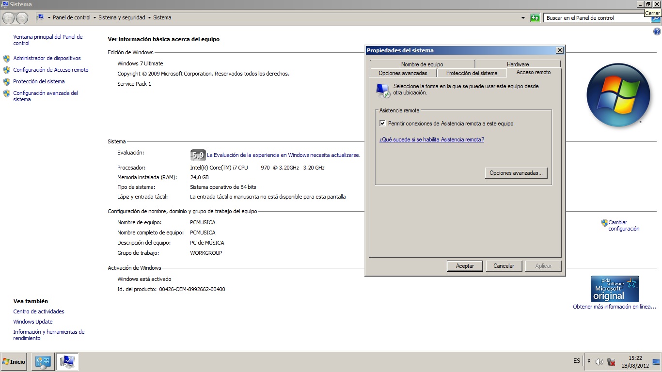

Yes, I post here two screens of the Allow Remote Access that aren´t exactly equal to those from Russ although I also have W7 Ultimate.
I tested it again today but still have the same error window as before, the one posted by Mani at the start of this post: "Remote Desktop can´t connect to the remote computer for one of these reasons:..."

Is that just all the nice GUI features shut off, or is that Minimized OS I see ? I wouldn't do the latter.

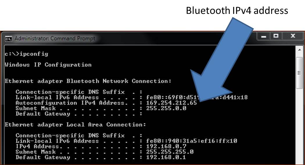

Did you obtain the IP address like Mani explained (and which by now is in the Tutorial) ?

I don't have time to write anything detailed right now, but I just wanted to check that you're using the correct IP address when setting RDC up. Referring back to an earlier screenshot I posted, are you sure you're using the bluetooth connection IP address?

Otherwise, Juan, switch on the LAN and try it over the normal LAN. I have the feeling that this is not Bluetooth related at all. But then use the IP address of the Ethernet connection )the 192.168.0.7 from Mani's example - but of course what it says at your place. Remember, obtain this IP addrress on the Audio PC, but enter that in the RDC data on the remote PC.
