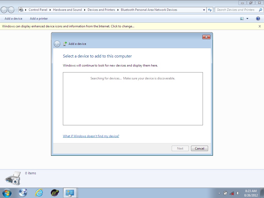

« Reply #17 on: August 26, 2012, 05:03:59 am »
Attached is a screen shot of searching for devices. This is where the laptop keeps searching & cant find any device. Similarly the audio pc also keeps searching.

« Reply #18 on: August 26, 2012, 08:08:01 am »
Ok, thanks !
So what you are saying is that this step does not work out, correct ?

« Reply #19 on: August 26, 2012, 08:57:10 am »
Yes that's right.
« Reply #20 on: August 26, 2012, 09:24:15 am »
Ok. Do both of the dongles show a blinking led (that can be not regularly blinking) ?
Do you have any other Bluetooth device in the house ? can easily be a phone. Switch it on and make it "detectable" (if you can find the choice) and from either PC try to find it in the same screen as you showed. Notice that "from either PC" is two-folded :
1. There might be something wrong with the driver install after all (not likely);
2. There might be something wrong with one of the dongles.
The above should give you the opportunity to find out what is wrong (hoping that you will at least now see something somewhere). So, dongle or install - and you will find out by swapping the dongles and see things happen on the PC's in question.
Notice that it can even be a USB port not working (internally not connected). And of course USB2 should be active, might you have gone the USB3 route with the NOS1.
Also keep in mind the line of sight which must be there.
Lastly, once you saw a device, keep in mind that at swapping things it will still show, no matter it can't be seen anymore. So, always remove the Bluetooth device first at a next (swap) attempt (this is in the Tutorial, just preceeding the screenshots I just showed).
Well ... ?
