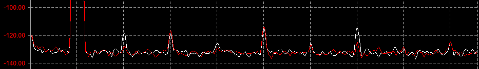

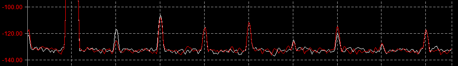

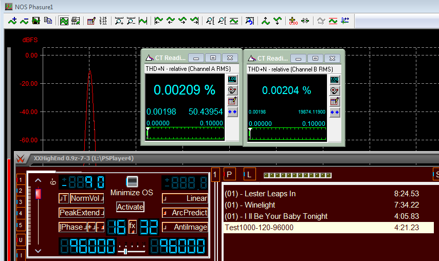

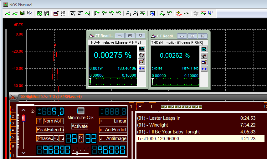

« Reply #5 on: September 14, 2012, 06:50:38 pm »
First picture placeboes you without Phase Alignment.
Second is with.
1Khz, Native Sample Rate = 96KHz, -9dBFS (test signal itself -3dBFS (to total -12dBFS)).
