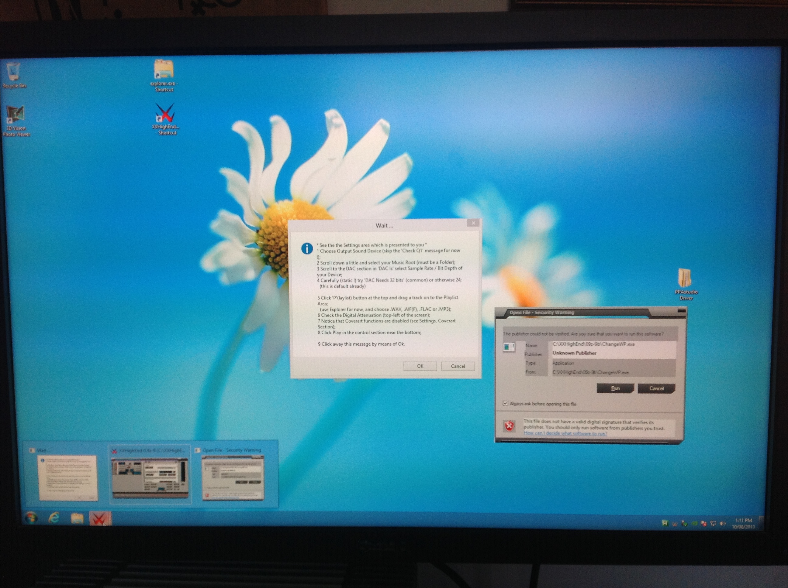

« Reply #8 on: August 10, 2013, 04:42:54 am »
I know this is an old topic, but the problem described so far is the same that I am having with the installation of 09z-9b.  As you can see from the attached image I am installing XXHighEnd for the first time on a new computer and get to this stage where I have a dialog box about a "publisher could not be verified" for ChangeWP.exe.  The RUN button does nothing, only the Cancel button works.  I am stuck!
Posts: 781
« Reply #9 on: August 10, 2013, 07:32:43 am »
Cancel that Peter.  Here is how I fixed it (for others in this predicament):  every dialog box that comes up asking for permission to run something  UNCLICK the "ask me every time" button EVERY TIME.  Then everything runs fine.
