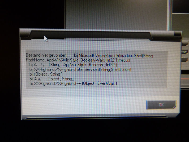

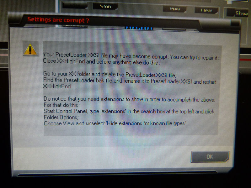

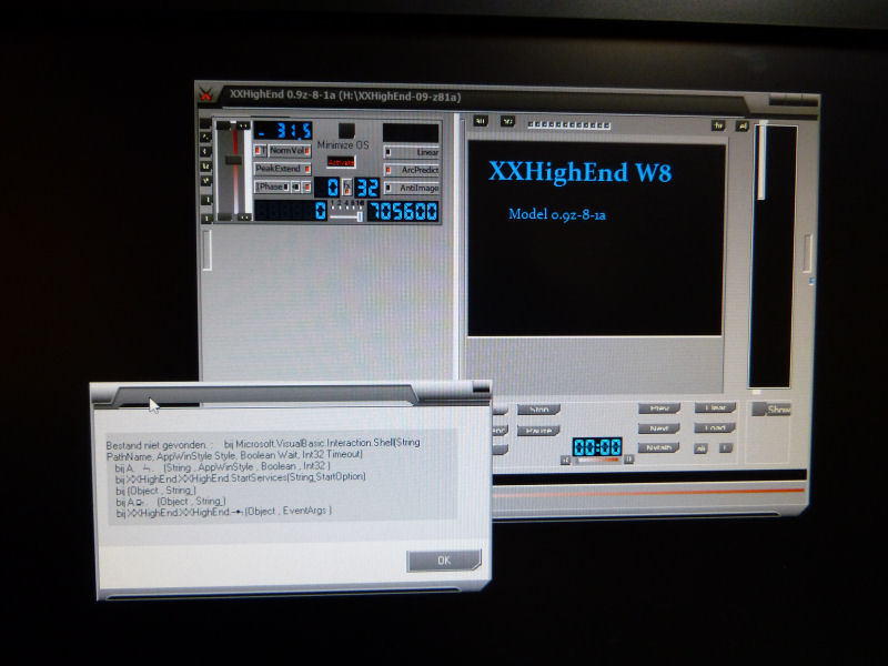

After unattended playback XX does not come back normally.
See the three images showing the errors (made with a camaera as PrtSCrn does not copy the screen).
W8 is minimized, UAC inactive... any idea's?
I remember something written about it but I can't find back that topic.
I changed the filename XSSIesetLoader.bak to PresetLoader.XSSI several times but that does not help.
« Reply #1 on: February 02, 2013, 02:02:01 pm »
Bert,
There is also a PresetLoader-FreshInstall.XXSI. Copy that over PresetLoader.XXSI.
Maybe that needs reactivation (and you will lose your settings).
That should help. But why it happened ?
And this is NOT the first time for W8 users ... scratching
« Reply #2 on: February 02, 2013, 02:08:58 pm »
Okay, I will but then should I first have Windows back into normal state (not Minimized)? Or should that not make a difference?
« Reply #3 on: February 02, 2013, 02:24:34 pm »
Perhaps because I have used the same directory from the previous XX folder used with the previous W8 installation?
Some settings were already filled in which they probably should not be with a fresh install?
I thought it had something to do with "/XXData" being the same folder taking over settings and such and all seemed to work out okay so the error was for me unexpected.

« Reply #7 on: February 02, 2013, 03:44:54 pm »
But are you saying that you still see those screens after you set back that Presetloader file ?
Updates were cancelled and yes, the same screen becomes visible (only after playing unattended again that is) so the situation did not change at all after changing the file names...
XX only seems to comes back normal when I do NOT close Desktop Services while playing unattended. The moment I activate this option then the Desktop will never return and the error messages from XX appear after Alt-H trying to get something visible.

« Reply #12 on: February 03, 2013, 10:03:18 am »
It looks like you did not leave that W7 Shell install to the defaults it presented. So, the path has its default and this is not to be changed. Can it be that ?
PS: Sorry for the late response but I never saw your topic updated yesterday !
« Reply #13 on: February 03, 2013, 10:35:20 am »
I guess this must have been the issue. Yesterday the shell programm could not find the Path to my W7 source I presented during the installation so I directed it to the W7 still present on the HDD (Dual Boot) which was accepted. I can't remember that I did changed the path to where the program files has to be installed though...
This morning after reading your last reply I uninstalled the shell program, restarted W8 and installed it again (all under normal OS conditions).
This time there was no problems finding anything (auto search for W7) and things installed fine again and the old Windows 7 shell came up as selected after logging on again.
So far so good...
Now the question if this all changed anything for the better and started a track unattended...
... the track just stopped and pretty quickly XX came back in normal conditions again!  clapping
Pfheww, thanks for your clever thoughts about this annoying issue, problem solved!
