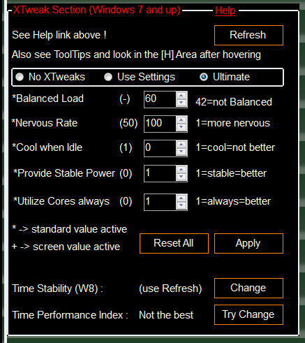

  • XTweaks Ultimate.
    As you can see here, there's a new group with "No XTweaks", "Use Settings" and "Ultimate". The latter is the new one, and it applies settings under the hood which overrules all other XTweaks settings, which remember, are about stability, and it stabelizes all to the max (that is, in this same field of setting sorts).
    Those familiar with the XTweaks settings will know that care must be taken with some combinations of settings, because they may disallow the cooling of the processor. For those new to this all, read the Help link as you see at the top for the general idea and what to do to find out what your processor can take and whether it will be a good thing to use XTweaks to begin with. Otherwise each of the XTweaks settings contains ToolTip help and it is really a good idea to read it all.
    And so it is as necessary for even the experienced XTweaks users to read the ToolTip help on the Ultimate (radio) button.
    To summarize this, using the Ultimate XTweaks setting may need to underclock your CPU.
    Important notice to users of the "XXHighEnd PC" : they 100% for sure will need to do that OR rev up the fans in there.
    Otherwise any PC will be able to cope with the Ultimate setting, BUT, the fans will rev up to intolerable noise.
    As a bonus, your PC will be the fastest as you have ever seen, as long as you did not need to underclock first.
    Please notice : Underclocking is not for everyone, also depending on the PC (motherboard). It will be perfectly allowed to ask questions on the forum on how to do it, and hopefully others will be able to help (not your humble developer though). However, it is and remains something that can easily bring you into troubles because of too few experience with it. And FYI, underclocking is not a common task to perform at all, overclocking is.
    Again a notice for the "XXhighEnd-PC" users : funnily enough (or not accidental ?) there is no problem at all with underclocking, because it can be done in real time and goes so easy that a baby could do it. Again, ask on the forum when needed, and this time expect your humble developer to answer these questions.
