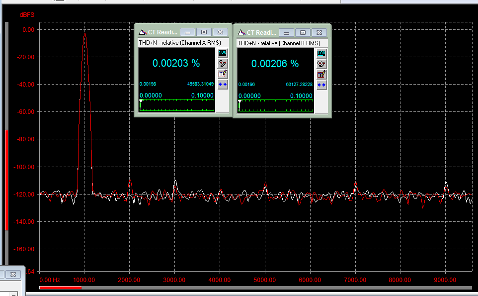

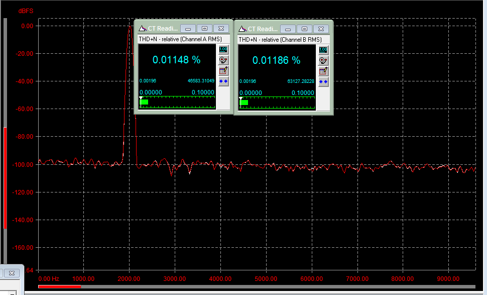

For the last two hours I have been looking for a good signal generator (which can save the generated signal to a WAV file), and you know what ? they ALL s*ck. Freakin' unbelievable. I knew this already, but I never looked that long. And the real problem ? Well, I once had one before a PC died, generated all my testsignals from it (which I still use), so at least one exists. But I can't recall or find which one it is.
In the end Arvind's question is not a bad one at all. So, if people may have an idea or even a hunch about a good program, please speak up.I can test it here.
Look below. All 1KHz generated signals. The first screenshot is what I use. The second one is AudaCity. It isn't even capable of generating 1000Hz when I ask for it. But look how bad it is. The third one is NHC - one of the most fameous and also annoying programs because it installs all kinds of stuff on your PC you don't ask for (and all not free). But look at it ...
And so I tried all I could find. The one worse than the other. It's almost like I have to make it myself (a program for it).
PS: And looking at all the variations I found, I now even wonder whether what I use is the best out there. Why would it ? It's just one of the random programs I found back at the time. I recall though that the author of it said that generating good test signals is not an easy job at all. I appreciated that when I found it and used NHC (free at the time) till then (again, compare). Today I should appreciate it even more.
