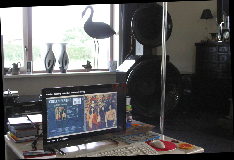

How do I make the cover art larger so as to occupy the entire screen as in the attached picture?
At present, it shows up small, in the top left corner and I often  can't read the titles.
Thanks  thankyou

In Settings there's a field "Coverart Max Width" (similar). Setting that to 600 will be OK for most displays.
Notice that this can't be a "max display width" setting, because the height is involved as well, plus Coverart can take more shapes than the normal CD cover (think DVD-A) *plus* it is you who decides to also show the Back of the album.
But once you found the setting you will get the idea easily.
