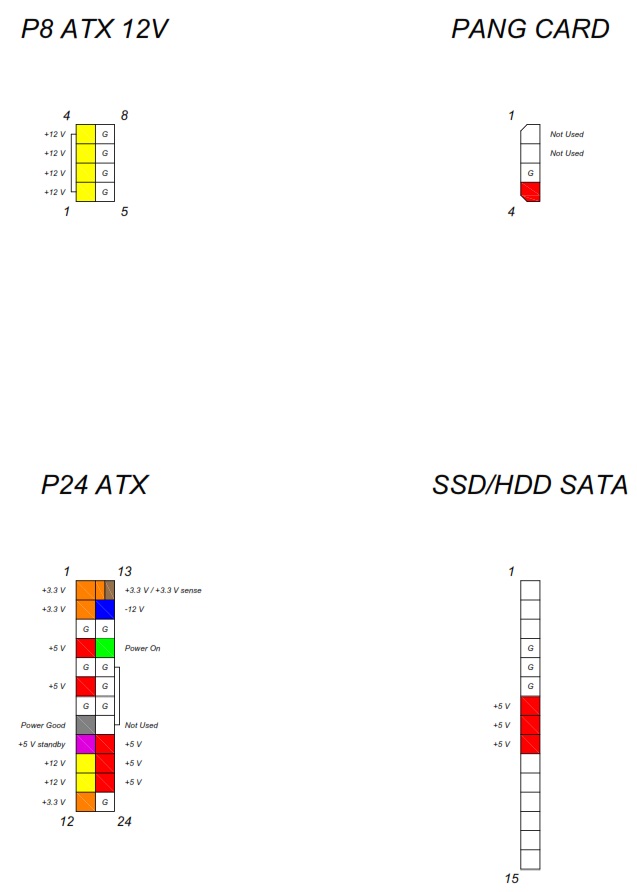

Within my own XXHE PC I have identified four points of interest: the P8 EPS 12 V plug; the P24 ATX plug; the Pang USB Card Molex Connector; the SATA power cable for the Samsung 840 EVO SSD.  The most complex and difficult of these is going to be the P24 ATX plug, but if we approach this in a methodical way I am sure that we can achieve the best outcome.  I have prepared a pinout of these four points of interest in my XXHE PC...

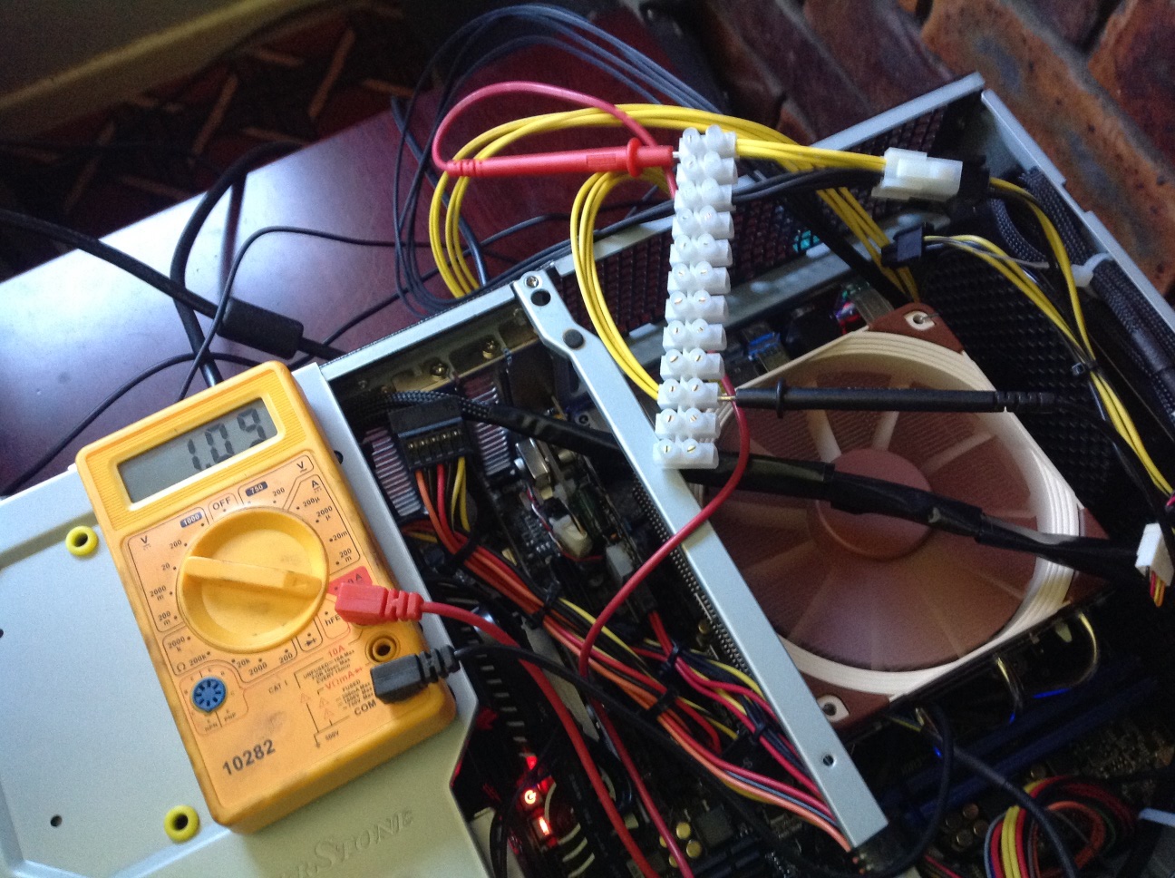

If you DON'T have a lab supply that displays the voltage and current draw, but you do have a multimeter this is still very easy.
STEP 1 - Unplug your XXHE computer from the wall.  Remove the 8 pin plug from the P8 CPU socket on the motherboard.  Plug in the 8 pin EPS extension cable (such as this) and cut all the POSITIVE wires in half (the yellow ones, not the black ones).  With the yellow wires that are connected to the compute PSU, twist them together and screw them into a terminal strip so that all four wires go into the same socket of the terminal strip.
STEP 2 - On the opposite side of the terminal strip screw in the positive probe of the multimeter.
STEP 3 - Screw the negative probe of the multimeter into a different socket of the terminal strip.
STEP 4 - Twist the remaining four yellow wires (that you cut earlier) into one group and screw them into the terminal strip opposite the negative probe of the multimeter.
STEP 5 - Plug the free end of the extension cable, with the multimeter wired into the middle, into the P8 socket of the motherboard.
STEP 6 - Make sure you don't have any potential shorts anywhere and then plug the computer power supply back into the wall and press the start button.  The computer should start normally.
STEP 7 - Take note of the maximum amperage draw displayed on the multimeter at startup (i.e. from the time you press the power button to the time XXHE is loaded), at idle (i.e. when the computer is sitting there with XXHE open, but is not playing music or doing any other tasks), playing music, pressing Alt-X to come out of unattended mode, and shutting down the computer.  This should be done multiple times with both minimised o/s and not minimised o/s
STEP 8 - Post the results in this thread
Note that in the photos below I have also directed the black wires (ground) through the terminal strip.  This is not necessary, they can be left entire and uncut.
