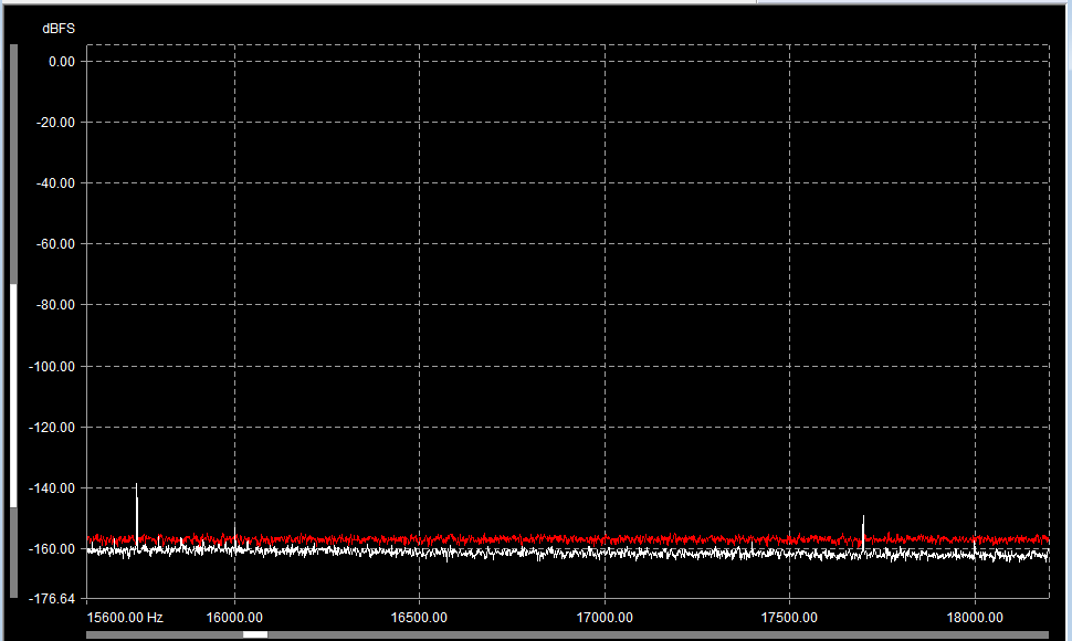

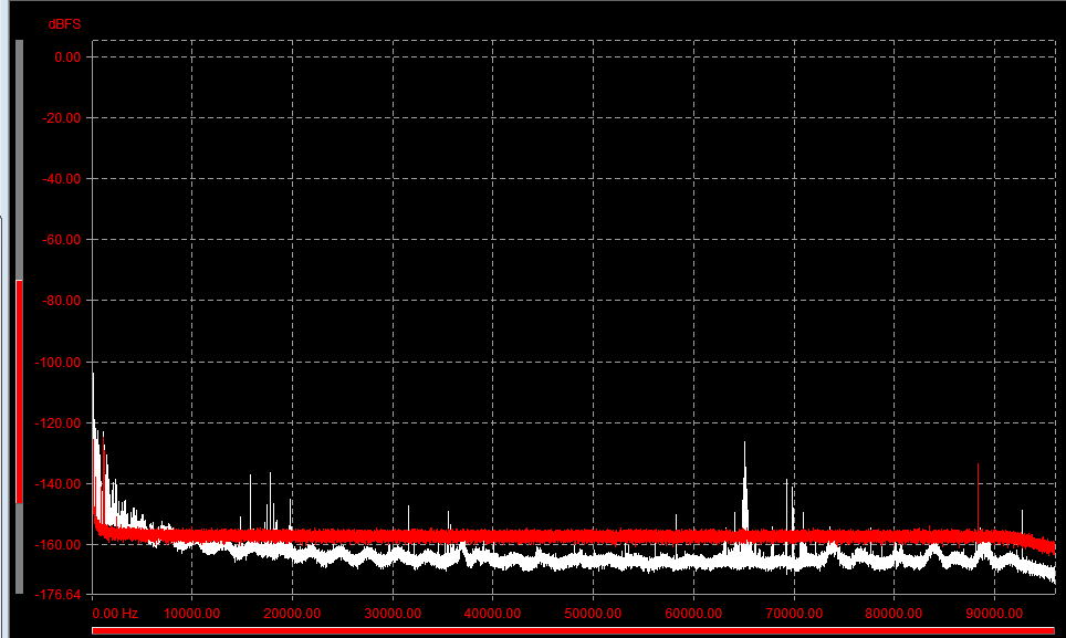

If you look at the excursion just before 18KHz - that's my dreaded PWM heating pump (not heat pump, which is something else). To the left of that the first next peak at almost the same level is the freezer. Both are on a totally separate mains ring (incl. different earth pin). Nothing, really nothing can take that out because it comes through air and sneaks into all, including the other mains ring(s) with different earth pins. You see it here at -140dB because it was "tweaked" that and this is all about the DAC's grounding (say guiding away).
If we look at e.g. 65Khz then I don't even know what that is. Same for the other spuria on the right hand side. It could be PCs, it could be anything. And then to think this sees 96Khz only, while beyond that there's quite some more, and especialy the very high frequencies may show nasty things. But next problem : how to measure *that* because no high bandwidth analyzer will show noise that deep. Merely think 120dB down max and if you envision that to have happened in the picture above, well, all would be completely spuria free !

You don't know it much, but in the not-isolated situation we would see a fairly high spike at 8KHz of USB noise. I forgot by now, but towards -100dB in above picture. From something like that we can at least reason out that it will influence the oscillators to begin with. My pump I could not see, which only happens now because the noise is more down. So now that will influence ? Well, don't think that without checking, because behind what you see here is another ultra low noise supply which is thus fed first by what you see (white trace) and of which I can expect that nothing any more shows but I will only know when I measure *that*. This will count for any PC spitting too, and everything else.
But yes, that is what I can do more at this moment; measure the supply noise to the oscillator(s); I'm fairly confident that nothing will change to my pump's visibility (because that is always a matter of guiding out and I don't know how to do that better) but possibly we can learn something from the remainder. And then still not easy, because who says if I put up the same measurement now, it shows the same; can be a matter of the neighbors just finished with the dishwasher.

So, did that. But funny ... nothing changed much apart from just that pump.
This is all what's left of the pump (17700 HZ) and in the left the freezer.

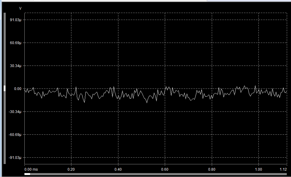

Here the clock supply noise (this is 3.3V positive) :

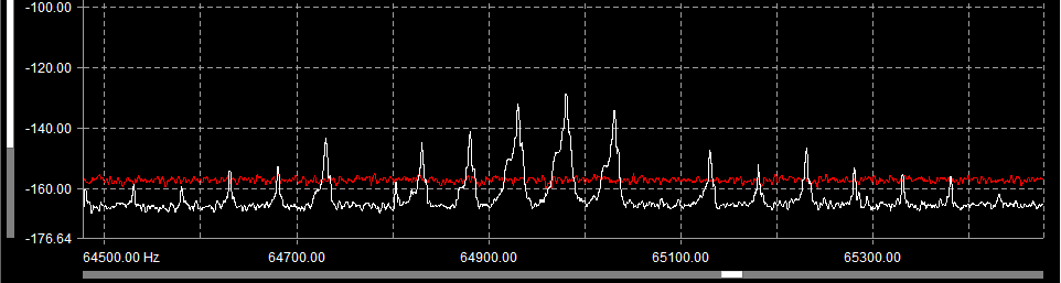

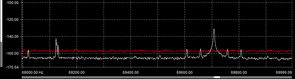

And might someone recognize something in these details (possibly regarding SPSU's) :
So that is all I have for unrecognized anomalies.

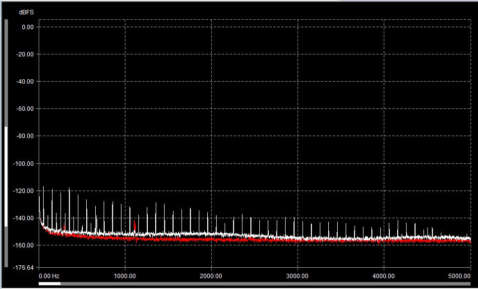

Roughly 50Hz harmonics?  You guys in Europe have 50Hz mains don't you?  SMPS for various appliances.
« Reply #143 on: May 19, 2014, 10:10:02 am »
Anthony, hmm ... I did not even see that. But is there any logic in why only there ? So all is quiet, expect for that little area.
And of course in the lower region. Here :
Beyond that it stops. Except for that small area ...
