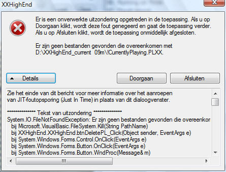

......If you want to load new tracks : start XXHighEnd, click Clear, load the tracks, click Stop and click Play.
The <Delete> button is very important! After the <Clear> you need to use the <Delete>- button to get a new track list
When you use the <Delete> button twice you get a XX crash.
Johan
« Reply #5 on: November 21, 2007, 04:19:07 pm »
Hmm ... I don't understand the first part, but the second part (delete twice) will be solved.
And ... since the first delete already isn't necessary for anything (IMO), any virtual second is too virtual to cause problems. rofl

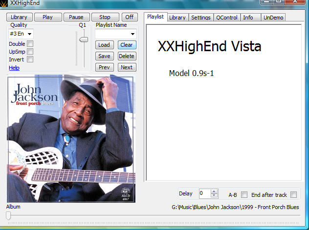

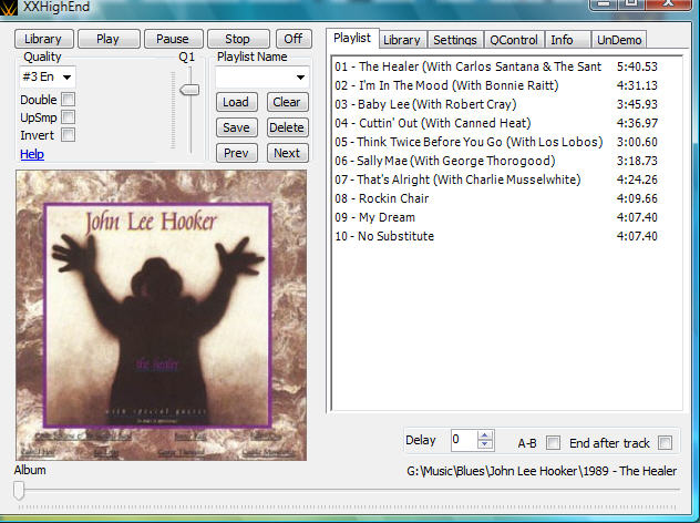

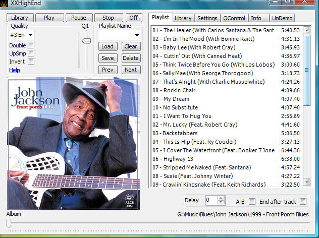

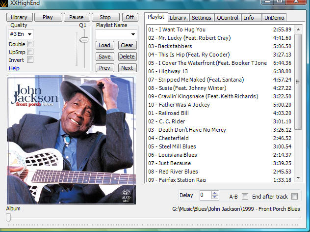

If this is working differently in your XX, please let me know ...

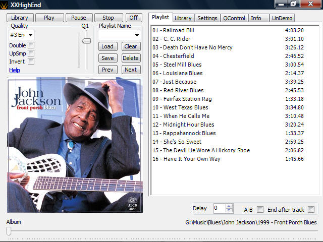

Screen 1: Start XX, Load the cd and start playing Unattended
Screen 2: Open XX, Stop + Clear
Screen 3: Select new cd, Load
Screen 4: Play, Stop and Clear (Sorry wrong TAB)
Screen 5: Select "The Healer", Load
Screen 6: Delete and Load, all ok
As you can see the playlist is getting longer and longer. Yes I am using the Stop and Clear button. Only the use of Delete button eliminates the tracklist from the past, all Healed! Stop and Clear works, when you don't start the player. You can Load and Clear all the tracklists.
 scratching
These problems starting from XX 0.9s-0/1.

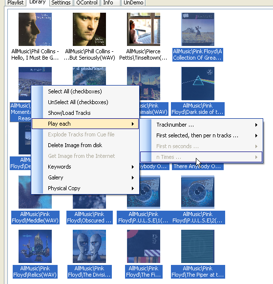

« Reply #14 on: February 12, 2008, 12:49:46 pm »
Hi Andrey. Two things :
1. You are correct (afterall ... you said it before) that eliminating the played tracks from the playlist (which happens at UnAttended Play only -> inconsistent) is not handy. Note though, that since you first mentioned this, the maintaining of "selected" tracks (hence, the one which is playing when you wouldn't explicitly Select) is there. I mean, you could try selecting 3 tracks in the Playlist, go UnAttended, bring up XX, and you'll see that those selected tracks are still selected. Now, *this* will be the means how I'll change the current way of working into a future way of working; that selected track feauture will show you were you are in the Playlist, with all tracks showing as you want. IOW, it is not necessary anymore to show the playing track at the top (hence remove the ones above it which just played). Ok ?
2. If you look below, you see that I seclected a bunch of Pink Floyd albums, and the mouse pointer is at "Play each" - "n times". This will be doing what you want for repeated play (all the selected albums, or better "items" (which can be tracks just the same)). Will be, because at the time (few months back) I wanted to implement this, I found my self without time to finish it before a planned upgrade, and after that other things became more important.
All 'n all, no, what you ask for is rather normal, and as you see, already thought of (and yes it includes your earlier remark, no matter my response back then Happy) . It's only not really there yet. sorry.
