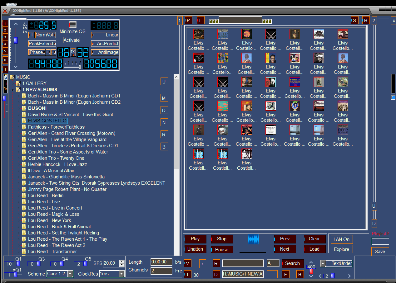

Hi Peter - attached are the logs I hope they are the ones you need.
Also attached is a picture of the xx gui the thumbnails have red borders around them but the text at the top left is blue (OK grey in the picture but otherwise blue).
Hope this helps. Let me know if you need anything else
Just noticed the Q settings in the attached picture - will change those just now!!
Best Paul.

« Reply #20 on: January 01, 2014, 08:51:13 pm »
Hi Bert - Can you clarify what you did to get red letters not sure I understand.
« Reply #21 on: January 01, 2014, 09:45:35 pm »
Paul,
I think that bert means to click the "Don't do anything with Cover Art" to let the Cover Art display. If XXHE is activated, then the frame of the Cover Art will be red when you play a song. After that, you can deactivate the Cover Art again and you will be able to see the red display as expected.
Now I remember that is how I got the expected info in red...
« Reply #22 on: January 01, 2014, 10:34:13 pm »
Hi Alain - Thanks as it happens I had already done that but without success.
Anyway I tried a complete re-install of XX and hit further problems. So in the end I had to restore the OS to a previous date - then a complete re-install with a new activation key (my previous key would not work) and now I have red letters. All is working fine.
I do not have a clue what can have happened but it must be something I did - anyway all is working now - thanks.
