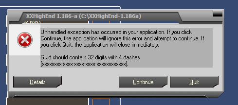

I set to "No XTweaks" and reinstalled XXHE and reactivated. Same messages appear:
"Something wrong at obtaining value 04". Then
"Something wrong at obtaining value 02". Then
"Guid should contain 32 digits with 4 dashes" .. (see picture)

« Reply #3 on: February 07, 2014, 08:08:54 am »
Hey Stanley,
This doesn't make sense to me;
You used W7 before, didn't you ? So what changed ? OS ? PC ?
Once all is stable try to reactivate it, because it just should work.
I think you interpreted this like "reactivate XXHE" and thus also "reinstall that". But that is resetting everything to the erroneous situation again. So I meant : Re-engage XTweaks (if you want of course) when all is stable.

« Reply #4 on: February 07, 2014, 08:20:27 am »
There is something else, but I must do this by heart now :
After setting to No XTweaks and you quit XXHighEnd, look in your XX folder for a file XXAnalysis.dat. That is, I think it is there and if not it's in your XXData folder;
Rename that to XXAnalysis.daa or something and keep if for me for possible later jusdgment.
But possibly it is not there at all because the error occurs before it is made.
And another thing :
I vaguely recall that I received the same error, BUT I interpreted that as something wrong with the (.XXSI) settings file and in that occasion I kill XXHighEnd (TaskManager) to next restart it. Since this is not long ago it can very well be I had that when installing 1.186 on my own W7.
I am sure I did play with XTweaks settings, so it's not something general that doesn't work (anymore) for W7. After that I changed to "Ultimate" and anyway I only saw the error once.
When this was indeed the situation after my first startup of 1.186 under W7, then this is the sequence to follow :
(with the notice that in my last used settings I had "Use XTWeaks Settings", which also is the defaullt after an XXHE install)
- Start XXHighEnd.
- Message with the "04" comes up.
- Kill XXHighEnd through Taskmanager.
- Restart XXHighEnd.
No problem any more ?

« Reply #5 on: February 07, 2014, 04:04:43 pm »
 unhappy
I tried all the suggested actions but the messages keep appearing. Not when XXHE comes up, but when I press the Settings button.
I found an "AnalysesA.dat file and renamed that.
Stanley
« Reply #6 on: February 07, 2014, 04:13:15 pm »
Ok. In your XX folder there's a NoXTweaks.tss file. Rename that to NoXTweaks.tst and tell me what happens.

« Reply #10 on: February 08, 2014, 10:28:11 am »
Stanley,
If you go into power options (the green battery icon in Control Panel) can you see something odd there ? I wouldn't know what, but from the program it looks like there is no "active power scheme".
On this matter, just go in the advanced settings and change something, save it, and of you like, change back and save.
Maybe this helps, I don't know ...
If this doesn't help, it looks like something is wrong in the Registry. Long shot, by I don't know of anything else at this moment.
