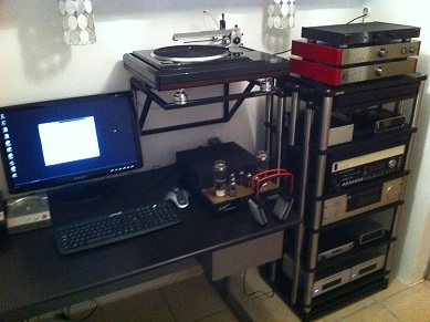

In my LP digitization 'studio' (see pic below). This is a self-contained space, with sound insulation and a semi-faraday cage. It sits 3m away from where Le Monster currently sits. Even with the Orelinos playing 'enthusiastically', I doubt there would be anything getting through.
Pros:
- virtually no vibrations
- greatly reduced EMI (my mobile goes dead as soon as I enter)
- nice, clean environment (totally isolated, air filtered, humidity controlled)
Cons:
- long USB (3-5m)
- long ICs (8-10m) - I have a pair of 10m high quality double-shielded XLR microphone cables already

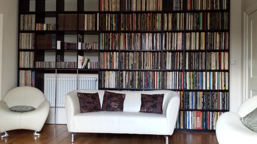

Ok Mani. With that all set, shield that radiator on the cabinet's sides. Maybe your LPs last longer then. Happy
PS: This is a kind of joke I wanted to make ride away when I saw the picture, assuming that for sure you have throught that over. Just curious though ...
« Reply #9 on: February 11, 2014, 06:47:51 pm »
Ahhhh, but that radiator permanently is switched off. There is another radiator on the opposite side of the room near the window, but even that is usually off. This was never a problem when I had the Sauermann monos - the room would warm up nicely with them. Oh well, I'll just have to use the room's Victorian fireplace (which now runs on gas and not coal... fortunately).
But thanks for the warning...
