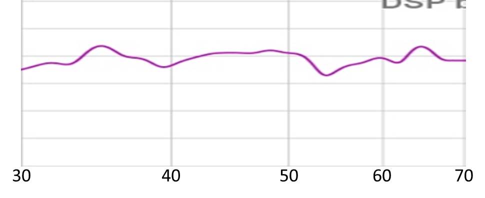

I finally got around to measuring the response of the Orelos in my room and... oh boy!
Pic 1
This shows the response from 30Hz to 70Hz with the mic placed just in front of the speaker vs. at the listening position. There's simply a MASSIVE dip between 65-35Hz at the listening position. Each vertical is 5dB, so the dip is up to -25dB! It's no wonder that I've had an issue with the low end since the day I set the Orelos up. Increasing the overall bass gain seemed to help, but is was obviously totally screwing up the overall LF/MF/HF balance.
Interestingly, with the mic placed close to the speaker, the response is  very flat - a testament to how well the speakers have been set up by Peter in the first place.
Pic 2
Peter and I worked together over the weekend to achieve this response... at the listening position!!! I set up a measurement system in the room and sent Peter the first pic via email. He created a new filter for me that I could load into the speaker's bass DSP and sent it back to me via email. We iterated quite a few times until we achieved this response.
« Reply #83 on: February 23, 2015, 08:32:27 pm »
The new settings are incredible, in other words, the speakers can be pinpoint adjusted to the listening position.  yes clapping

Like I said earlier, all the rooms with the best bass that I have heard have been measured.  It can really make a big difference.
Great that Peter was able to change the DSP to get the room working...now that's customer service right there.
« Reply #86 on: February 24, 2015, 08:55:34 am »
Yep, I'm really impressed with the result too. I have to admit that both Peter and myself were really unsure whether we could use the DSP to overcome the room's null point in the 40-50Hz region. But the fact that this can be done with DSP is just great.

I would recommend anyone with a pair of Orelino/Orelo speakers, who feel they currently have bass issues in the room, to give this a go. I mean, why not use their DSP to overcome such issues?
BUT... I have to say that although this whole process wasn't massively difficult, it WAS time-consuming and certainly not trivial. You have to get your head around the room equalization software, set up an appropriate sound device with input/output, set up the mic, learn how to take measurements and capture the outputs, learn how to load new filters into the speakers, and finally learn how to manipulate those filters for fine tuning.
Provided you can do all this, you should be good to go!
