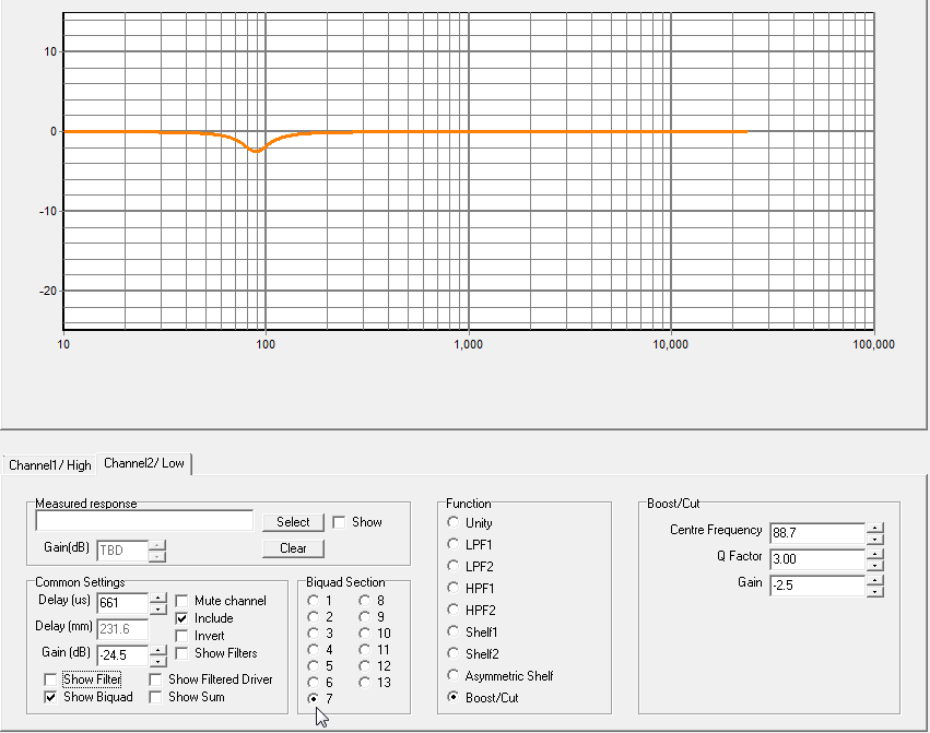

Let's start with me telling that I always wondered why the speaker needed a "notch" at ~90Hz. But, it needed it (to present a straight line performance) and so I applied it. However, it was in my mind that it could be a room anomaly, never mind I measure from very close (like 2cm).
So for a few weeks already I was tempted to remove this notch in order to see whether I'd receive a coloured sound from it, or whether it maybe would be for the better. And, after playing with Windows 7 for a week and perceiving the more deep down from earth bass - and after going back to Windows 8 that deep down being gone again, three days ago I finally did it.
Here you see that notch and this thus went out.
Within a second it was clear to me : Windows 7 bass was back.
Well, not for all its aspects (W8 bass is better) but the deep down earth was there.
Aha.

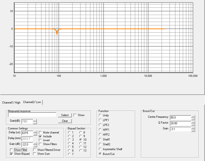

Without me realizing it really back at the time(s), below you see how the Orelino was tuned. Mind you, although the design in the basics is rather the same, the drivers are totally different. Please notice that although the MKII was tuned later than the Orelino, the MKII was tuned from scratch, and no Orelino (DSP) base was used. Here :
Same thing ? You can say so yes. There's a small difference in the peak frequency and also the range is smaller, but with the notice that this has been for myself only and wasn't setup in as much detail I applied for the MKII which was "for you". But you can bet I would have come to the "more same" when I had payed as much attention (and no exact 90Hz would have been used, to name something).
Anyway, same thing.
So :
Done.
Yes, with the big fun that I already had it done without me realizing it. So, assumed it is W7 which needs this while W8 does not need this, this is the difference for W7 against W8 in the LF area.
Please notice that this now has been determined audibly and that it is of course no real science that I myself judge W8 (without the notch) to sound the same now as W7 (with the notch).
For me this does not imply a buzz like W7 shows it, so I am the most happy with this. I suddenly found the best of both worlds ... The bass quality in optima forma, with the highs quality W7 never will show. The both combined makes the more profound highs more soft in the mean time.

I've just run a series of 1/3 octave band tracks (ripped from the MFSL 'Soundcheck' CD), from 20Hz up to 20KHz. It's clear that there is a 'suck-out' between ~40Hz and ~80Hz in my room. I've never noticed this before. The 20Hz, 25Hz and 31.5Hz tracks show plenty of energy (the 20Hz can hardly be heard, but it definitely energizes the room). There is a significant drop in energy on the 40Hz, 50Hz, 60Hz and 80Hz tracks. The energy starts returning on the 100Hz track.
Hey Peter, my comment here obviously didn't trigger your memory of applying the filter7 notch. Oh well...
I've just applied the Unity setting to filter7, and indeed the LF is much, much better. Nice 'tweak'.
However... over here, I'm still missing the really low-LF stuff. I've only tried a few tracks though, and it could well be that these simply have no real low-LF to begin with. (Or it could be that I really need to get the NOS1a and PC back in the main room and use short ICs.)
