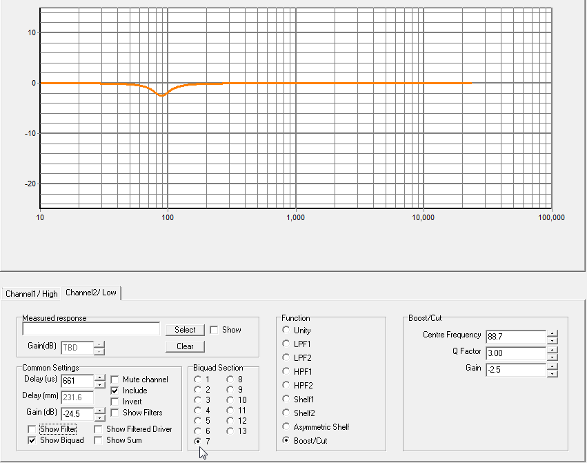

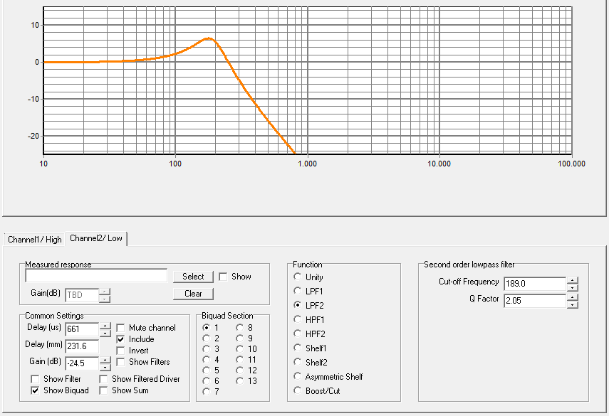

Load your currently used Filter Settings (do not forget a different gain setting for left and right might you have that in order) and select Filter-7 like you see in below first picture.
Change it from being active as a Boost/Cut filter to an inactive filter by means of setting it to Unitiy.
You see that in the second picture.
Give this to both speakers and again, don't forget a possible different gain you applied to both.
Save these settings with a name which makes clear that the settings are with Filter-7 shut off.
Sit back and listen.
Next, let's have some interaction via this topic over what you perceive for the better or the worse.
I know, we are only with 4 of us ( Windows 8 ), but let's make this our first challenge of how a small communicty can improve a speaker; it was intended like that and this is a real life example.
What's the difference with software or a DAC eh ?

OK, in addition to what has been done in the first post you can do what you see below.
For the first screenshot :
Tick Filter 13, select Boost/Cut and apply what you see in the right hand side.
For the second screenshot :
Tick Filter 1, and change the Q Factor from the 2.30 currently in there, to the 2.05 you see.
Both can not be done separately. Thus apply them both.
I say nothing ...
KnB
Posts: 125
« Reply #3 on: August 31, 2014, 08:08:21 pm »
Great stuff! just arrived back home from a very nice weekend (in my boat) Have done the changes and will "test" more tomorrow.  Happy
