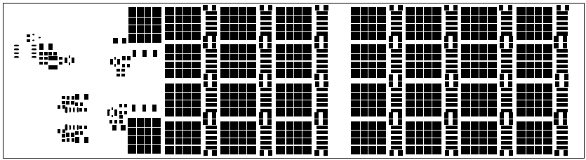

So ...
When you use a fairly normally sized monitor, you see an about 1:1 scaled screenshot of "something" of the first PCB, which will be here next week. Say that this is the most physical product I have at this moment because it's the confirmation of the (Chinese) company of how the so-called solder mask sheet is going to look like.
A solder mask sheet is an (in this case) metal laser cut sheet with holes in there and if you overlay it on the PCB under/in the holes you see the soldering pads of the PCB.
But now guess what this sheet is for in our case ...
(just shoot)
Anyway, this first PCB to really put to getter is for a fully differential power amplifier (an amplifier with two voltage sources both working in opposite direction, with very good common mode noise rejection and "no 2nd harmonic" exhibit).
The THD+N should be better than 0.00003% but how much better is yet to see (and measuring it could be a problem).
And yes, this is a power amplifier and it does ~52Watts into 8Ohm.
The gain will be 18 which is just about right for everyone but the 52W can of course not bear too inefficient speakers but normally it will do and for an SPL of about 100.
Slew Rate is 1950V/us (swoon).
If this works out it could be the best amplifier ever, that is, looking at the distortion figures only (but then it should sound the best as well). And notice that this is not stupid Class D, so no HF sh*t  either.
Also it will be a "cold" amp, or IOW if you don't use it or play softly, it will hardly consume power.
While this is to be a great power amplifier, we're still talking D/A converters. Now 8 of these can be in there, max ...
grazy
For your fun, and looking at this part of the DAC only, try to envision how huge the heat problem is, and how much time it takes to find setups which can dissipate sufficiently. Meanwhile I am still so that I want the heat in the cabinet to be very low *and* consistent. Especially the latter is of crucial importance. Just think about how resistances will vary when the heat varies (bad for D/A converters !).
Now think that I can easily work for a month to find good solutions for such a problem. Really so !
What's also problematic (but I create the problem myself) is that I like to have linear power supplies. This is not easy at all when so much power is required (so think x8). And, not sure yet if I am going to make it with that, but at this moment it looks like it is going to work (power supplies will be in a separate cabinet anyway, which btw implies its own problems with high currents).
Btw, the modularity is already visible here;
Envision that each of the large squares contributes to the current needed. Now, I may need maybe 8W of power only. So I also need only a fraction of those black squares. And the design is so that we can just leave out what is not needed.
Or :
I may need that 8W for my woofers and I need 0.5W for mid and even less for the tweeter. And thus in my own DAC each module (in pairs - stereo) will be (or can be) different.
But first it must really work.
(first parts for it arrived yesterday and the remainder upcoming Tuesday and then ... smirk)
