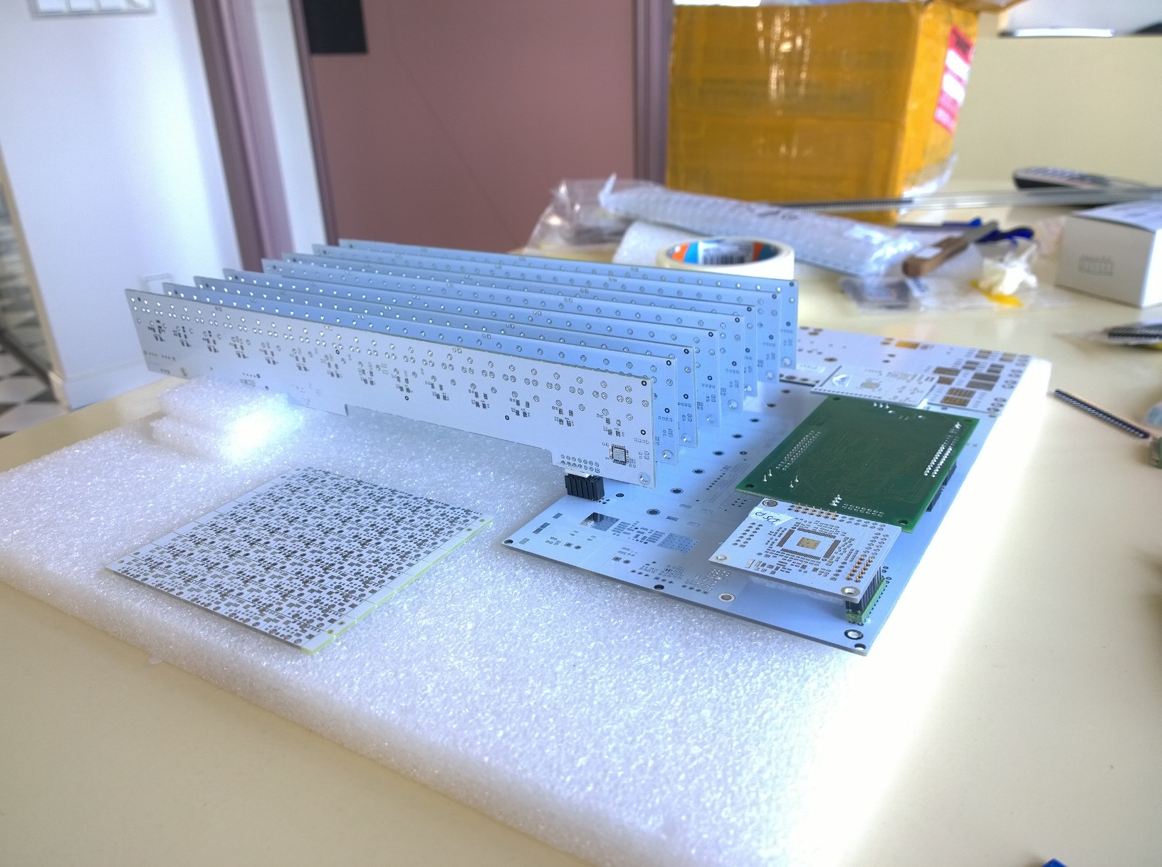

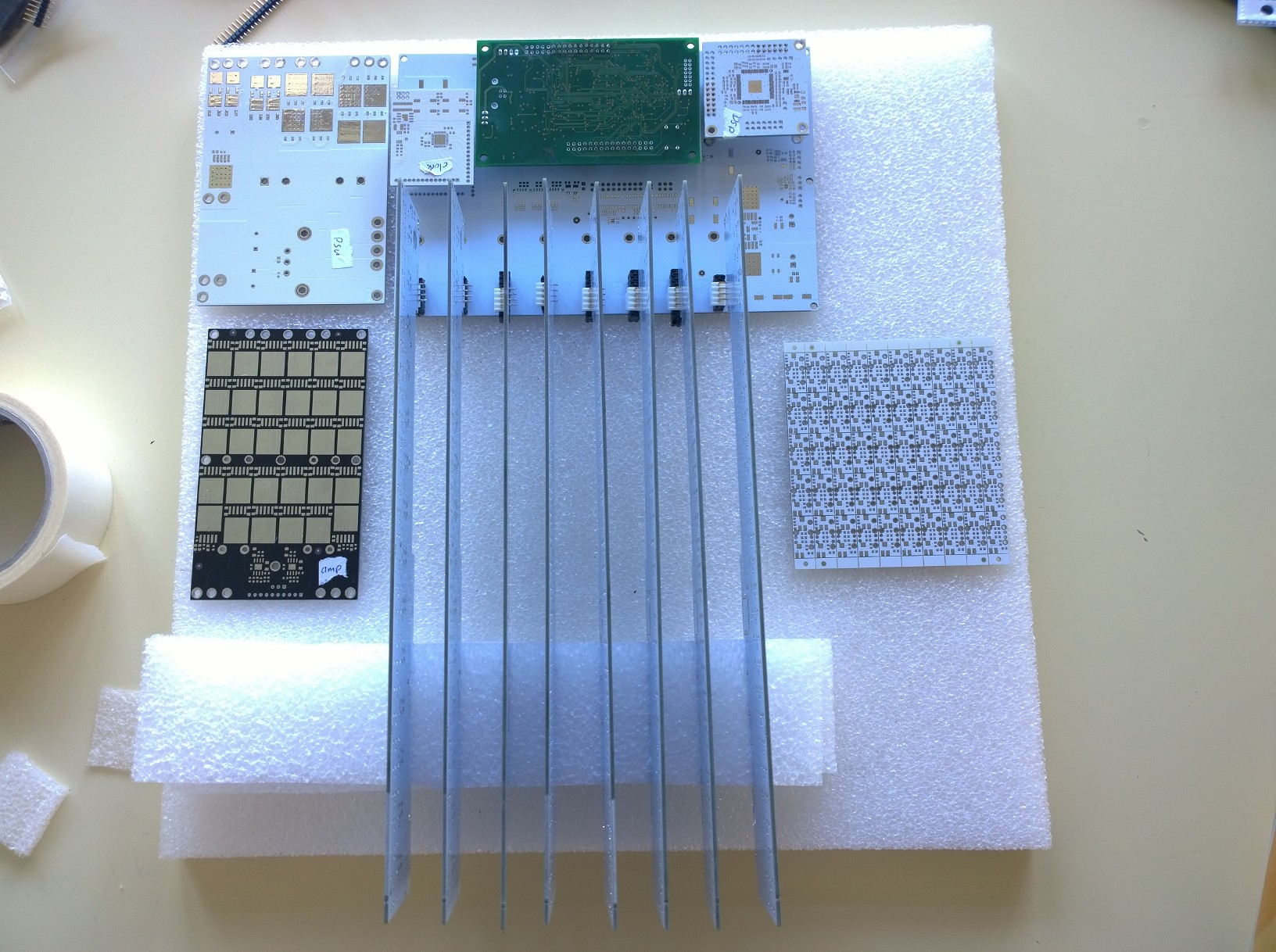

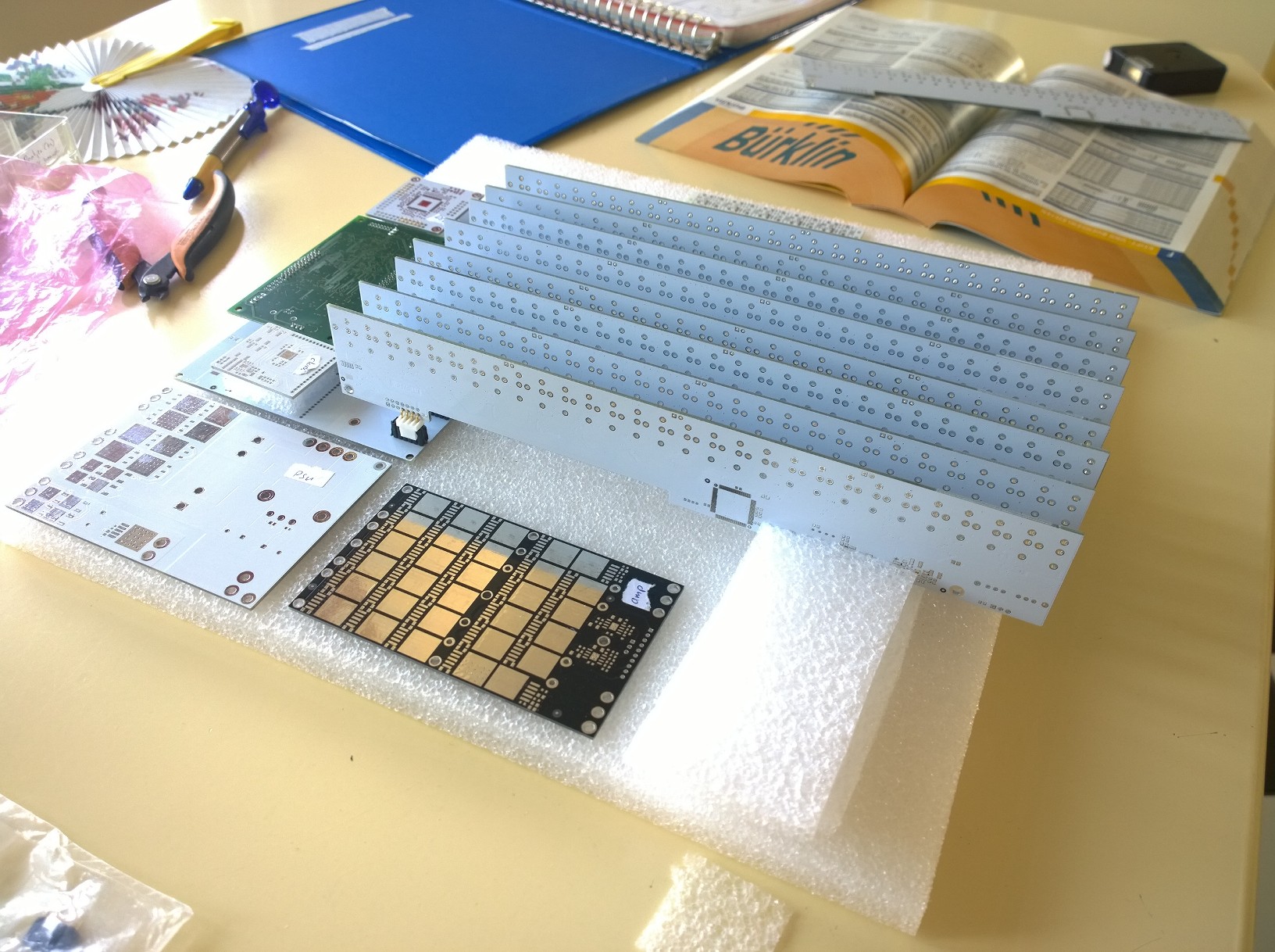

The loose boards in the left are the Linear Power Supply (the part of it which goes in the external case) and the new design of the Power Amp (black). The Power Amp is optional per (max 72W RMS) channel.
What you see on the right hand side is a 50 pieces of "bit modules" (they are all connected together per the production means). They connect to the sides of the ladder boards, in parallel.
You see 8 ladders here, for 8 channels. 56 of the bit modules go on one ladder (2x 28 bits).
High Resolution link Phasure NOS2 02
High Resolution link Phasure NOS2 03

« Reply #185 on: August 13, 2015, 10:34:20 pm »
But there is a small problem ...
yes
Need a bigger case?
Looks rather good by the way.  Thanks for the update.
