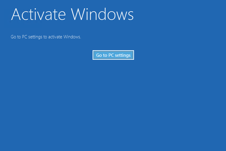

« on: June 18, 2015, 11:53:44 am »
...logging in (min OS). Not so dramatic though, clicking the button brings me to the desktop and nothing else happens as if all is activated.
Not sure how long this will last  dntknw

« Reply #1 on: June 18, 2015, 12:28:44 pm »
Activation worked overhere. Must be connected to the internet though.

« Reply #3 on: June 18, 2015, 12:49:01 pm »
I think the problem is only in minimized OS. The activación in normal OS  works well but when you go into min OS  and go to control panel/system it shows not activated again.
For activación in normal OS run cmd as administrador and type:
                                                      slui 3
Then pops up a blue screen asking for the key. Type the generic key suggested somewhere in the forum and you are done.

« Reply #6 on: June 18, 2015, 02:21:31 pm »
Maxi,
                                                      slui 3
And exactly that does not work over here. "Key can not be used" or something.
This has always been so. But such a screen popping up not that I recall (and Bert is not suggesting that either - maybe you do ?) ... unless ... uness I far away recall this from W8.1 to be the case also (or "already").

« Reply #8 on: June 18, 2015, 04:10:53 pm »
Not in my case. I didn't get such message in normal OS. It seems to activate properly. dntknw
But in min OS the blue screen pops up from time to time.

« Reply #9 on: June 19, 2015, 07:49:35 am »
I have exactly the same problem as Bert but it only happens in minimised it does not happen in fullOS. It does not seem to cause a problem (it just clicks away).
« Reply #10 on: June 19, 2015, 08:23:37 am »
Not important and only good to understand :
What happens is that the PC Settings screen (metro app) that needs to deal with this, does not run (and can not even run in MinOS).
And then for additional unclariry (haha) :
I have the same screen and situation in Normal OS. But in my case because I'm really not activated (can't even enter the Key with success) and the apps don't run in Normal OS either (because of the set UAC level) - so same story.
