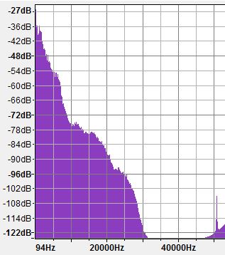

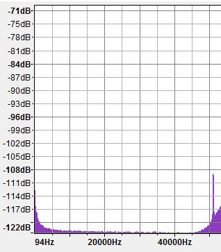

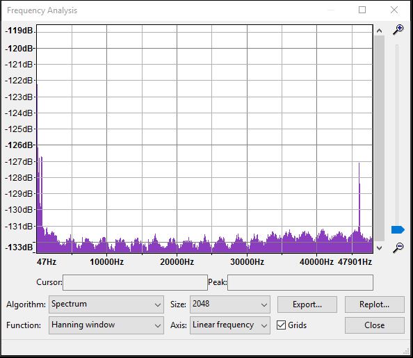

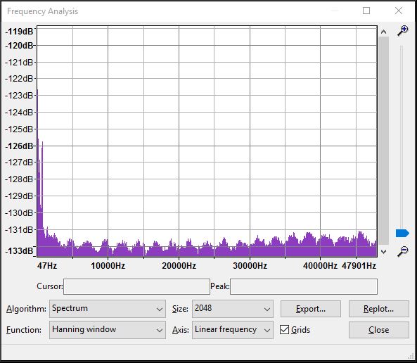

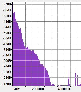

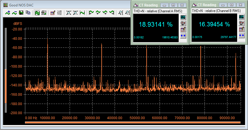

Look below. I coincidentally needed that this morning for something else. It is a 10KHz test signal and genuine NOS.
If one likes that, one likes distortion. It is from this topic/post :

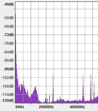

World's best measuring NOS DAC : Phasure NOS1 (it is a large topic so let it rattle until it downloaded all the pictures - it is Reply #130 in there).
The first picture (the orange one - the same as you see below) is a NOS DAC without filtering (remember, filtering = upsampling !)
The second picture looks quite 99% the same, but it is from a DAC which is now used as NOS and thus no filtering again.
The third picture is that same latter DAC and but now 4x Upsampling with a nice filter is applied (I don't know any more what filter that was at that time).
All you need to do is envision that the first picture (also shown below) can not be improved upon because the DAC is not capable of a higher sampling rate and/or does not supply the necessary number of bits to do that.
You know what ?
Squeeze a 20Hz tone through your system. What do you hear ?
Well, if it is 40Hz capable, you will hear 40Hz. That is a similar distortion as you see below but easy to proove because you can hear it so easily.
(with the notice that 20Hz should be inaudible to you)
Disclaimer before I'm aimed at : People owning the Orelo MKII speaker of course will hear nothing ineed.
Yup.
« Reply #10 on: November 05, 2015, 11:54:54 am »
Help ...
I am laughing myself, now I see this picture pop up in this post.
My story is nice and valid, but please notice that the "harmonics" you see are a bit outside of the audio band. That happens with a 10KHz base tone ... (which I thus coincidentally ran into this morning).
Anyway, still the idea is clear hopefully.
Edit / PS : But you can compare the distortion figures (the 10% you see) because they are calculated from the in-band response only). For that, dive into the link I gave, where you see that the same signal can end up to be 0.004% but which can not be justified by these plots (so you need to believe me).
