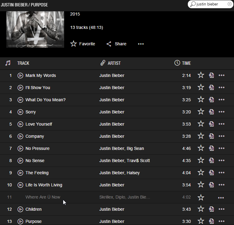

« Reply #5 on: December 08, 2015, 10:42:26 am »
No, this one for real does not work. Also see below - in the Tidal player I can't play it as well (it is greyed out).
Btw, I just checked the program (and log files) and now see that I can avoid the Unauthorized message. Actually it was denoted in the program as "to do".
In the picture you can also see that the character is a capital ü. I checked the album itself, and that seems to be correct.
Case closed, I'd say but I must amend XXHighEnd a bit ...

« Reply #7 on: December 08, 2015, 02:25:28 pm »
Arjan, yes, once you know such a thing can be checked like that, then it is easy. But I didn't know either.
Apparently that can happen within an Album.
A bit of a stupid thing of course because what must I do ?
Just don't obtain the Track in the Playlist Area is easy but people may wonder "where is Track #11 ??". Obtain it but sort of grey it out is better, but not easy at all because obviously XXHighEnd doesn't know about such things and adaption to it can be hidden deep in many functions.
Thanks ...

« Reply #10 on: December 14, 2015, 04:31:19 pm »
I have been in contact with Tidal: when a album-track is grey and can`t be played (streamed) it is because Tidal don`t have the rights for that track.
Can be because of a feat artist in that track
Tore
