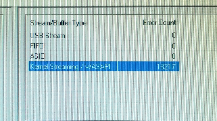

I see this. But changed bugger from 4 ms to 2 ms and they where gone.
Just now going back to 4 ms and no errors apear prankster
SFS 0.10

« Reply #13 on: January 23, 2016, 10:21:07 am »
Thank you Gerard.
Another question I have (and it relates to Gerard's post) is :
How long does it take before you see things stabilize ?
So remember, I talked about that for "audibly and 10074" but I am also confident that this happens to you (Johan, Arjan) and everywhere (OSes). Example :
You press Play and right away a pile of Streaming errors pop up. A few 100 more after a second, more afer 5 seconds, maybe a handful after 10 seconds and then it is quiet.
Or :
You press Play and right away a pile of Streaming errors pop up, and that's it.
In this case, think of an audible tick when you press Play. Regard this a Driver error (and virtually my bad but no issue).
Or:
Right away a few dozen USB Stream and FiFO errors show, and that's it.
These situations per definition happen. Here they do and I have to regard them normal.
Still they can stay away just the same, and the higher SFS will "cause" that, usually.
I hope it doesn't need explicit telling that the errors don't automatically reset when you press Play. So keep track of the last score at pressing Play for a next attempt.
Otherwise changing the sampling rate (in the Control Panel)  will reset the count, but always change to a multiple of the sampling rate you play with (like to 88200 (and not 96000) if you use 176400). Otherwise for 100% sure errors will emerge right after pressing Play.
« Reply #14 on: January 23, 2016, 10:34:30 am »
