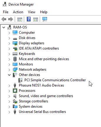

What I suspect is that something is wrong in general, but I can't tell what. Bad memory is perhaps too far sought but possibly you see something in Device Manager, like unrecognized Devices.
What MoBo do you use there ?
Btw strange : I was quite convinced that you have an XXHighEnd PC, but can't find anything (invoice) about that.
Did you (need to) do anything for Driver installs etc. ?
I have the same mobo as the XXPC.
No drivers installed.
A lot of unrecognized Devices in Device manager.
Will check what Devices it is in vendor/device search
PC- Asrock X79 Extreme 4-M -
« Reply #28 on: January 27, 2016, 10:35:42 am »
OK Arnt, then I suppose that should be solved first, with the notice that one might remain :
See at the mouse pointer. I never could/can get rid of that and I don't even know what it is (maybe other people know ?). So I always disable that (see little black arrow).
« Reply #29 on: January 27, 2016, 10:38:29 am »
PS:
After you know it plays all right from RAM, do not forget to boot into the BASE again in order to apply the Drivers etc. *there* !!
Doing that in the RAM version is useless (it will vanish after a reboot). Ok ?
