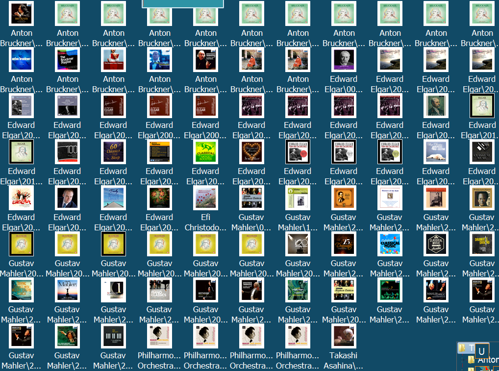

On my Music Server I have XXHE 2.04c running, and the Tidal searches seem to work well with popular music but the classical searches are not working.
For example, if I type "Anton Bruckner" or "Edward Elgar" or "Gustav Mahler" into the search I end up with an error message "Error (1) in forming Tidal Path...Check Naming Scheme in Settings (Data Location section).  Also see the Search Root field at the bottom which can be 'wrong'".  Those searches work just fine in Tidal itself.
Both of the locations in the error message seem correct, and if I then type in a search for non-classical music everything works just fine.
Of course, I am typing in composers, not artists, so perhaps the problem lies there...and with the Naming Scheme.
« Reply #1 on: February 15, 2016, 07:56:35 am »
Hi Anthony,
They all work here (a total of 80 or so results). I recall this problem (not really Classical related I'd say) and it was dealt with on the forum.
But I use 2.05 ...
« Reply #2 on: February 15, 2016, 08:23:38 am »
But if you don't mind ... what a pothetic mess comes from this. I can't imagine that this is usable. And a bit 99% Japan Philharmonic oriented.
« Reply #3 on: February 15, 2016, 11:09:13 am »

« Reply #7 on: March 02, 2016, 01:01:59 am »
That all worked just fine.  2.05 definitely gets results with classical composers where 2.04 did not.
Thank-you for your help.
