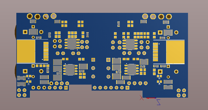

The G3 incarnation of the B'ASS is way better than the original B'ASS, because it is now more than that.
How ?
It consists of 3 different Gain Stages.
Here they are :
1.
The configuration as originally planned, but with one stage of amplification only. This is because of #2 below which is the more formal one, and this (#1) config is actually strange as it works all right but without justification that I myself can discover. It changes the sound, it does that for the better, and with more amplifiers it changes the sound more and for the more better. But my guts tell me that all what it does is make the sound slightly more fuzzy, together with a more bassy sound. Completely nothing wrong with it, but only more expensive than #2 below.
2.
This configuration can be regarded as the schoolbook application for the setup involved, which I never really got working at first, which is all related to the power supply and oscillation (and the very high slew rate of the chips involved, which people may recall as over 2400V/us).
New PCB's were designed for a new supply (actually the regulation) and now it worked. And mind you, now the vagueness of "current amplifier or not", can be scratched because now it is a real current amplifier (so #1 is "half that").
3.
Drumming !
Your good old gain stage.
He says what ?!
Ad 1, 2 and 3 :
The thought of this has been dealt with in between many lines, but originates from my finding that a certain chip on your momentary gain stage is responsible for the breaking in of the NOS1(a). With the explicit thought that such a chip is required anyway, the situation of #1 emerged, which has this chip in the chain but in the NOS1(a) as is/was and the remainder of the "current" amplification was posed to be in the external cabinet. This is to be read as : how to move the chip from your NOS1(a) to the external box which is thus impossible and thus think of a design which allows the chip to remain in the NOS1(a) and chain thingss such that it works together with what's inside the external case.
... Which I in the end did not like for physical + $$ constraints. So :
With the idea that the external case would not be the cheapest upgrade anyway and falling back to the more normal "upgrade situation" which implies building-in the NOS1(a), I could now think of any setup that suited me, and which incorporates that chip you have on the gain stage at this moment.
A first trial batch of new PCBs was ordered so they could fit in the NOS1a (the "a" now not between braces because the a version occupies more space to begin with), which for myself meant that the famous chips (one per channel) were taken off the old gain stage and put on to the new oneS (see more below). This fitted all right (and played well too), but I regarded it unnecessary "wired" so again a new PCB was designed. This PCB looks quite similar to the old one (for the gain stage) and attaches to the DAC board again (no wires involved).
Side note : The production of these should have gone out 10 days ago before our small vacation, but this failed because the W10 machine of concern (with the PCB design software) gave up on us all together. The machine is up and running again, but I expect 4 weeks before the PCBs now can arrive.
OK, but apart from the "opportunity" to provide the old (means of) gain stage, why do it in the first place ?
The answer is simple : The sound is so totally different with the #2 option (also with #1) that you can be sure to have a brand new D/A converter with a so changed sound that you may like to listen to the old sound once in a while.
And the NOS1a had no sound of its own ?
Yes, funny. It hasn't. But once you listened for a year (which is what I really did) to another "neutral" sound, you will discover that certain favours of, say, accuracy are audible indeed !
As usual, this hard to explain in words, but an attempt :
Let's imagine that we have random guitars with a certain mid (frequency) sound; what we perceive from that through the NOS1a (NOS1 I forgot a bit) is the sound of the string(s) with (relatively) few guitar body. Mind you, the body of the guitar largely makes the sound. It is this body which is added largely by the B'ASS and after listening to that for a longer period of time, the "flavour" of the NOS1a with old gain stage is one of strings. And oh, they are all so accurate, which is perfectly audible because of no real fundament (lower frequency) disturbing it, but it is not "complete" so to speak.
The sound of the normal NOS1a could be summarized as a very accurate and pinpointed sound, which accuracy etc. comes forward because nothing vaguens it. It is not false accuracy, but it is incomplete. So let's say that the flavour of the NOS1(a) is one of incomplete music sound, never mind that you do not recognize this at this moment.
I myself have been looking numerous times for less accuracy with the B'ASS amplification because most certainly it feels like that. But I could not discover any by means of explicit listening;
all the accuracy is still there, and now the bonus : a 1000 more sounds are there because so much is playing at the lower frequency (but think upper mid to begin with and most certainly not sub low or something). An example of it could be the now impossibility to not hear what the lyrics are. OK, this already was so largely, but it is now more so.
Mind you, in the above I am  talking from the experience with #3, which is the latest incarnation of the B'ASS and active over here for a small month.

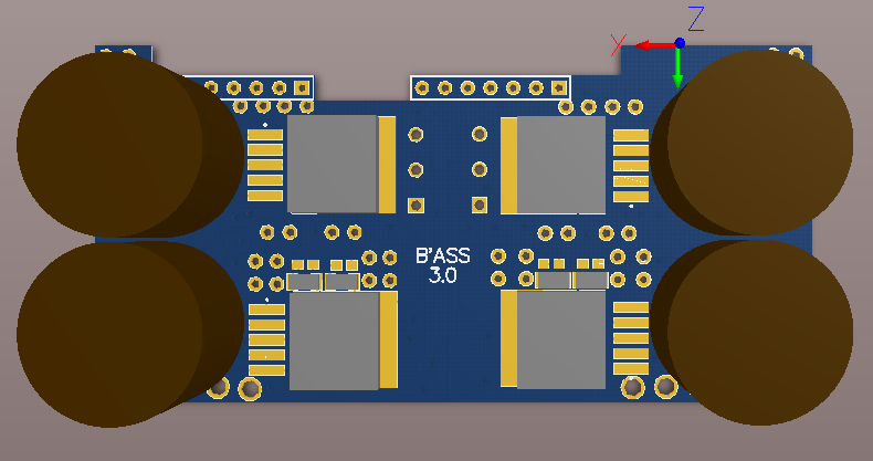

The design
First off, the G3 gain stage is Double Mono now (this was not so with the gain stage you still have in there). I am pretty sure this is audible in the Left/Right separation but to be honest I can only have my judgement from comparing with the first PCB with "integrated" Left and Right, more so than what you still have in there. Anyway if you look at the board you can envision a vertical line going in between the "AS" of B'ASS and it is there where the board galvanically splits (with a small bend at the top because the right hand input signal needs some space).
Next, a new power transformer (one of them) is now matching the situation so good that the main power supply (right hand leg) remains almost at ambient temperature (maybe it is one degree Celsius above that). In itself this is a requirement for the ultra low noise (double) regulation on the G3 PCB, so the benefit is two-folded. And let's keep in mind : the lower the temperature, the progressively longer the longevity.
The main (shunt) power supply is now regulated so it can take 700mA for plus and 700mA for minus (was 500mA for the NOS1a (300mA for the NOS1)) with a dissipated heat as describe above.
The amplification is always in differential (Balanced) configuration, never mind you use Single Ended outputs only. This is no different from how the DAC works and how the old gainstage worked, but it *is* different from the original idea about the B'ASS (where SE stages could (virtually) be ordered). The additional advantage of this is that your NOS1(a) remains to be fully balanced, just in case you want to use that later (while today you may use SE only, like with the 75 Ohm BNC connection).
There's a 13600uF of buffer per channel (was 470uF) so the high slew rate can really be served when required. However, besides the possibility of assembling your own caps, there's also the possibility to assemble smaller capacitance (and with that - smaller sized) caps which again makes a difference to the sound  - see the bottom side and the four holes under de capacitors.
The output level is now 1dB more.
Means to configure the B'ASS G3
On top of the PCB you will find a bunch of jumpers (10 per channel);
The default configuration will be the #2 and for example, to move to #1 requires pulling off 2 jumpers per channel and move them to another position. 30 seconds of work, outside the taking off of the lid. Moving to the original Gain Stage goes similar.
Of course a guide for this (including pictures) will be provided.
