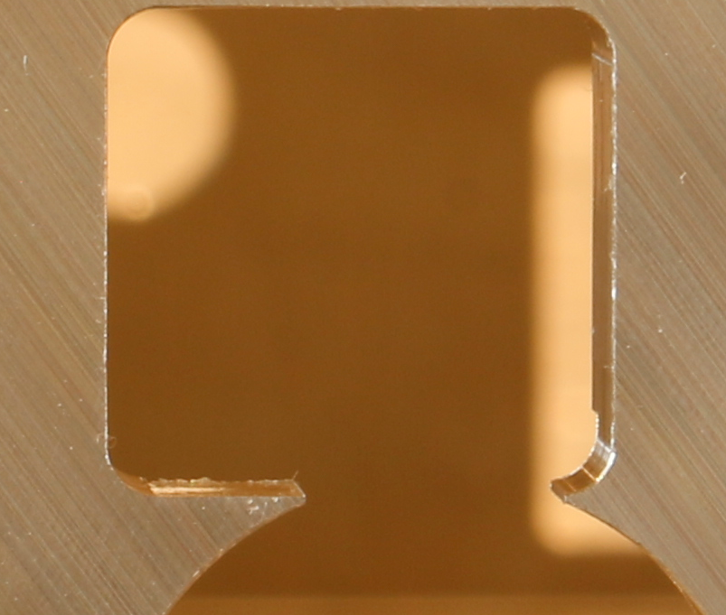

XLR Input completely in the left, XLR/Jack Hybrid Output next to it.
RCA Input and Output in the middle (above power inlet).
BNC Input and Output in the right.
As tried to lay out earlier on, in practice combinations are possible like BNC In and BNC Out and 2x additional RCA In. Or 1x additional RCA and 1x additional XLR In (which theoretically requires an XLR Out).
Knowing that the RCA and BNC connections require the same hole diameter, you can see yourself that it is possible to e.g. have 3 RCA Inputs and one RCA Output. Etc. etc. - as long as you keep in mind that with Single Ended In, there will be no Balanced Out (there's nothing in there which converts). Balanced In and SE Out can work, though (you lose 6dB of signal level).
For the real die-hard there's also the possibility of Balanced BNC in and Balanced BNC Out (RCA the same, for that matter). And when that is in order, there's still an extra input possibility because the large leftmost holes are Neutrik which can also contain RCA (or BNC).

Here's something else, which I personally regard a milestone :
It is the first official "Phasure activity" of our son Paul (who is 17 years of age these days);
It suddenly appeared to him that the controls in AutoCAD mighty much look similar to airplane and battle tank controls. smirk
So it is him who did the whole technical design. And mind you, this was given to a CNC machine, and the result is flawless.
