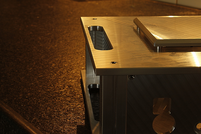

Guys,
It is virtually impossible to leave this untreated (not anodised). This is because aluminium will lose its shinyness (it oxydises) until you polish is with a cloth and next aluminium is so soft that it will scratch and becomes ugly.

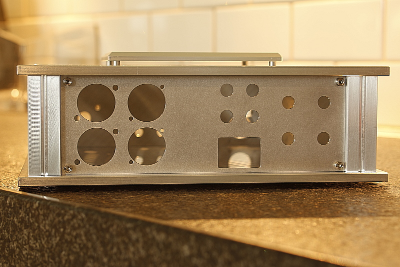

XLR Input completely in the left, XLR/Jack Hybrid Output next to it.
RCA Input and Output in the middle (above power inlet).
BNC Input and Output in the right.
As tried to lay out earlier on, in practice combinations are possible like BNC In and BNC Out and 2x additional RCA In. Or 1x additional RCA and 1x additional XLR In (which theoretically requires an XLR Out).
Knowing that the RCA and BNC connections require the same hole diameter, you can see yourself that it is possible to e.g. have 3 RCA Inputs and one RCA Output. Etc. etc. - as long as you keep in mind that with Single Ended In, there will be no Balanced Out (there's nothing in there which converts). Balanced In and SE Out can work, though (you lose 6dB of signal level).
For the real die-hard there's also the possibility of Balanced BNC in and Balanced BNC Out (RCA the same, for that matter). And when that is in order, there's still an extra input possibility because the large leftmost holes are Neutrik which can also contain RCA (or BNC).

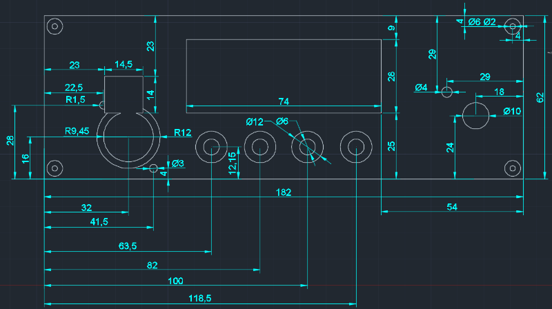

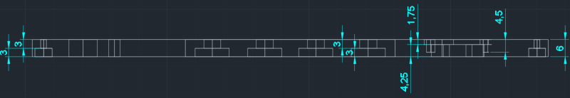

Here's something else, which I personally regard a milestone :
It is the first official "Phasure activity" of our son Paul (who is 17 years of age these days);
It suddenly appeared to him that the controls in AutoCAD mighty much look similar to airplane and battle tank controls. smirk
So it is him who did the whole technical design. And mind you, this was given to a CNC machine, and the result is flawless.

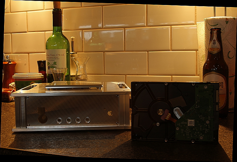

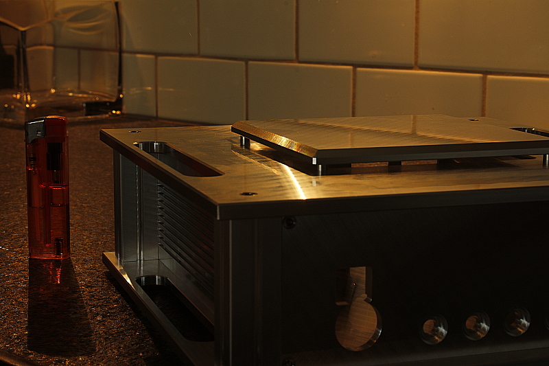

Here's the last one in the sequence "talking to myself" :
It shows how tiny the B'ASS actually is. Disregarding the beer, the wine and the schnapps, the 3.5" harddisk tells it all.
Weight is 2.5Kg, empty.

Peter, my eyes opened up when I saw the AC inlet right next to the single ended inputs and outputs.  Obviously I don't know how everything is laid out inside, and certainly not to criticise your layout, but personally I would have them separated as much as possible, and would stick the AC in the opposite corner.
« Reply #133 on: May 25, 2016, 12:54:24 pm »
Anthony, what opposite corner ?
Otherwise I don't know what you "personally" are all capable of, but maybe you should first realize the dimensions.
Also, you're a bit late with such a remark (assumed it could be useful) because nothing changed since May 8 (Re: The cheapest upgrade : B'ASS).
Anyway, of course I am thinking about that all. Btw, how bad does your NOS1 sound ?
bored
Let me know your ideas.
« Reply #134 on: May 25, 2016, 01:39:47 pm »
The NOS1 sounds fine, but I still have to be careful about where the single ended interconnects are routed or I do pick up noise.  I purchased a right angled IEC connector to make everything fit back there and I have a piece of foam in between cables to keep power and signal separated as much as possible.  At least with the NOS1 power and signal are at right angles so inductance is minimised, but that is not so with the B'Ass.
If feasible, I would move the XLR's to the right to make room for the IEC at the far left.  The real RFI source is likely to be the transformer ringing when the diodes switch on and off, so keeping the transformer away from everything is probably a more important consideration.
Anyway, these are just casual observations from the other side of the world Peter, and there is more to think about than the little item I raised.  I thought you were getting tired of "talking to yourself", as you put it - haha.
