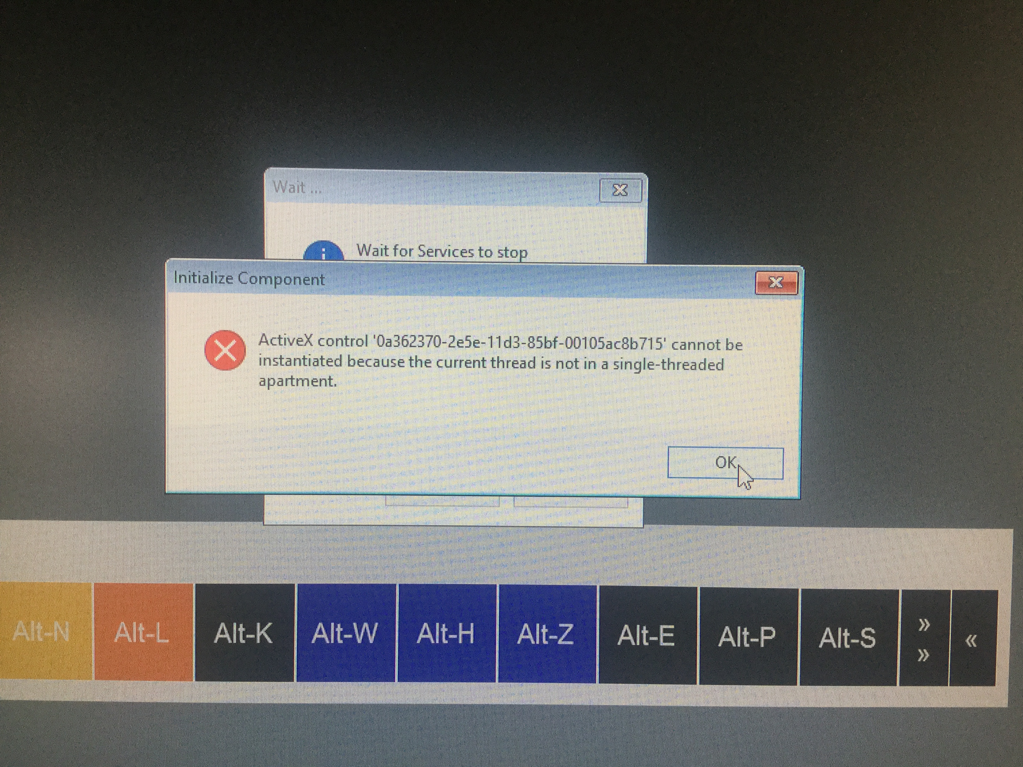

I downloaded the upgrade patch, unzipped it over the existing XXHighEnd 204c version. All seemed to go well, but when I started XXHighEnd (Minimized, Unattended), just before I expected to see the coverart and hear music, it stops and shows the attached message:

« Reply #1 on: June 18, 2016, 12:30:36 pm »
Stanley,
I have have seen this myself but when I sat down for it to solve it, I never could copy the problem.
In this sequence :
1. Does a reboot help ?
2. If not, a higher SFS should help. Not that I want you to use a higher SFS, but I wonder whether it helps you.
Lastly, especially when you can not solve it by means of a reboot, can you post the XX (only that one) log file of such an attempt ?

« Reply #6 on: June 19, 2016, 10:15:58 am »
Hi there Stanley,
First an apology that I never saw your new post (forum, quirck) with new log file (I will look into it anyway).
But as I now see you managed ...
Point is that I had this myself 2 times (last time only 4 days ago and it postponed this upgrade because I wanted to find the cause) and at each each a reboot helped (the first time is weeks ago and I don't recall the situation but back then I thought "oh well").
I just don't know what it is. But stupid thing : this will be a normal message which in itself fails because of something not available anymore (it is during or after the shutdown of services). So my main aim is that this message normally shows and tells what is going on (perhaps a "File can not be accessed because it is in use by another process"). But I first must be able to copy the behavior again ...
Good for you that it works again !
« Reply #7 on: June 19, 2016, 10:21:34 am »
Stanley, maybe you can tell me ...
This message (see your screenshot) occurs when this other messages "Wait for Services to stop" is on screen.
What was your sequence in obtaining the log file ?
a. Bring up XXHighEnd, press stop in there and grab the log files(s);
b. Click away the error message, next the same as a.;
c. Click away the error message, click away the Wait for Services message, next the same as a.
Another sequence is possible too, but you get the idea of what I want to know; your log file (the larger one) ends somewhere, but now I need to know where XXHighEnd really was (stuck) and this depends on what you did ...
Thanks !

« Reply #8 on: June 19, 2016, 02:20:45 pm »
As far as I can remember I clicked away the error message (I did not click away the Wait for Services message), pressed Ctrl-Alt-X button on the Onscreen Keyboard and waited for XX HighEnd to appear. Then I grabbed the logfile.
I tried to reproduce the error message by changing various settings in "Services", but XXHighEnd doesn't show errors anymore.
On thing I might, I updated XXHighEnd by means of the patch while the MusicServer PC was ON. After rebooting the Music Server PC, XXHighEnd didn't show the error and works perfectly (Maybe this has nothing to do with the problem, but I add it for completeness).
I hope this helps, otherwise, please let me know.

« Reply #10 on: June 21, 2016, 05:33:51 pm »
By chance, I reproduced the error message again and thus also could avoid it again.
As you suggested it has to do with SFS settings. With my setting SFS=1; max SFS=60 there's no problem, but the error message shows when "Max the same as SFS" is active.
Hope this helps.

« Reply #13 on: June 27, 2016, 10:32:28 am »
The error message showed up again after I started both the AudioPC and MusicServerPC (which I switch off when away from home for a few days).
Playing a track Attended for a few seconds, press stop and Play Unattended, will make the message go away.
